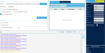

I am currently trying to program a nucleo board using USART. For this I am using the bootloader and Cube Programmer.
I first developed a program and tester it by programming via st link. My program worked with no problem. I then tried to program using UART.
I was able to connect but as soon as I started programming, I get the message Error :GETID command not acknowledged and then the nucleoboard is disconnected.
Here are my settings and the boot0 pin is tied to 3.3V.
When I program I can see on the oscilloscope that some part of the program is on and working but not fully as well.
Any idea ?
Thanks very much

‎2025-05-23 3:37 AM
Hello @EliazLB ,
I attempted to reproduce the issue on my end, but everything seems to be working fine.
Could you please provide the bootloader version ? Additionally, if possible, could you share your binary file?
Thank you,
Maryem.
‎2025-05-23 3:54 AM
The bootloader protocol version is 3.1 if that's what your asking for.
I saw a slight difference between your settings and mine which is that you didn't check the "run after programming" box. I tried to program the nucleo without the box checked and there was no problem. But as soon as I pressed the reset button I got the same problem as earlier.
So the problem might come from my code.
I've attached the binary file I'm programming onto the nucleo.
Thank you

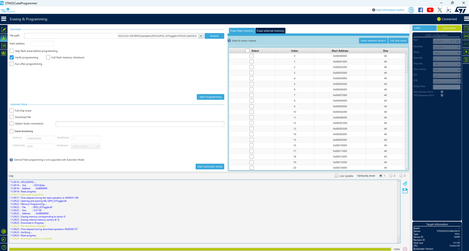

‎2025-05-23 4:09 AM
Thank you for your feedback.
Actually, I was referring to the bootloader information you can find when connecting the target via ST-Link.
Also, thanks for pointing out the "Run after programming" option being enabled.
Could you please confirm whether you receive the message "File download complete" before encountering the error message?
Maryem.
‎2025-05-23 4:14 AM
Here is all the informations :
I do get both messages :
- "download verified successfully"
- "File download complete"
And after both messages are closed does the error message appear.
‎2025-05-23 4:42 AM
Ok, I don't know why I never checked it, but despite the error message, the program appears to be working.
I tried with the example GPIO_IOToggle and the led turns on and off as it is supposed to...
The reset buttons seems to be working but only once out of every 10 times I press it.
‎2025-05-23 6:16 AM
This is normal behavior since the application starts running after flashing. The device disconnects because the bootloader is no longer active; the application is now running instead.
