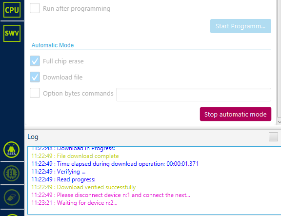

First programming was ok. After disconnecting and reconnect with second device, nothing happen.

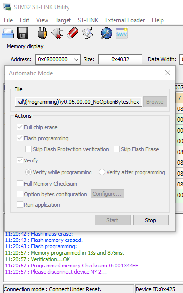

0693W00000FAklrQAD.pngUsing same set of hardware, but changed software to ST-LINK Utility.
Result: ok. Automatically programmed the second device.

Reply: That's my main purpose of using automatic mode. I must unplug previous board, and plug the next one. I expected STM32CubeProgrammer detect automatically, but it didn't.

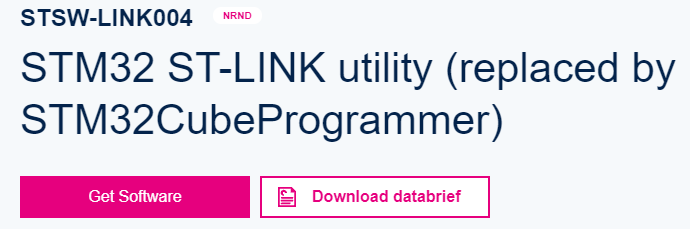

Reply: STlink utility worked fine as mentioned in original posting. I thought this software is replaced by STM32CubeProgrammer?
https://www.st.com/en/development-tools/stsw-link004.html
Hi @FArdi.1​
ST-Link utility is not recommended for new products.

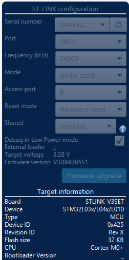

I have updated to latest version (V3J8M3B5S1), then do power cycle of STlink V3 hardware and target board.
Problem is not solved yet. STM32CubeProgrammer was able to detect disconnection, but no response after connected to target board.
Attached is STlink configuration and target info. I have tried reducing frequency until 1Mhz. Problem is still there.
