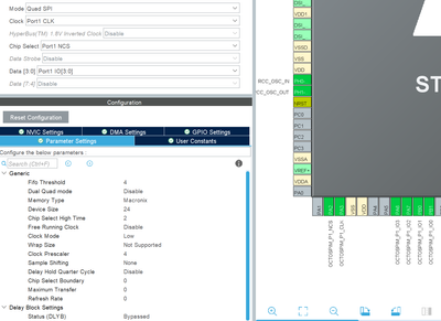

Hello, I'm a novice developer who recently started working with embedded systems. I've been struggling significantly with implementing an external loader for several weeks now...
I'm developing an external loader for **MX25L12833F** (16MB Quad-SPI NOR Flash) connected to **STM32U5G9ZJT6Q** via OCTOSPI1, but it continuously fails in STM32CubeProgrammer. The loader compiles successfully and generates a `.stldr` file, but programming operations fail.
The problem is sector erase. Writing, reading, verification, and mass erase all function normally, but only sector erase does not work properly. What could be the reason?

Hello newbiee,
When I compared your SectorErase function with another official external loader, I've noticed a difference in your loop condition.
Your code:
while (EraseStartAddress < EraseEndAddress)
 Official loader:
  while (EraseEndAddress>=EraseStartAddress)
The difference is the ' = ' in the official version, which ensures that the last sector is erased.

Hello again!
Any updates on this matter?
My work was busy, so I was late checking this. I'm truly sorry. Even while handling other tasks, I made some gradual modifications to the sector erase section code. I believe I had also applied the code you mentioned, “while (EraseEndAddress >= EraseStartAddress)”. However, at that time, the sector erase didn't work. I might be getting confused. After applying the code you suggested, it's working normally!! Thank you so much!!! :thumbs_up:
