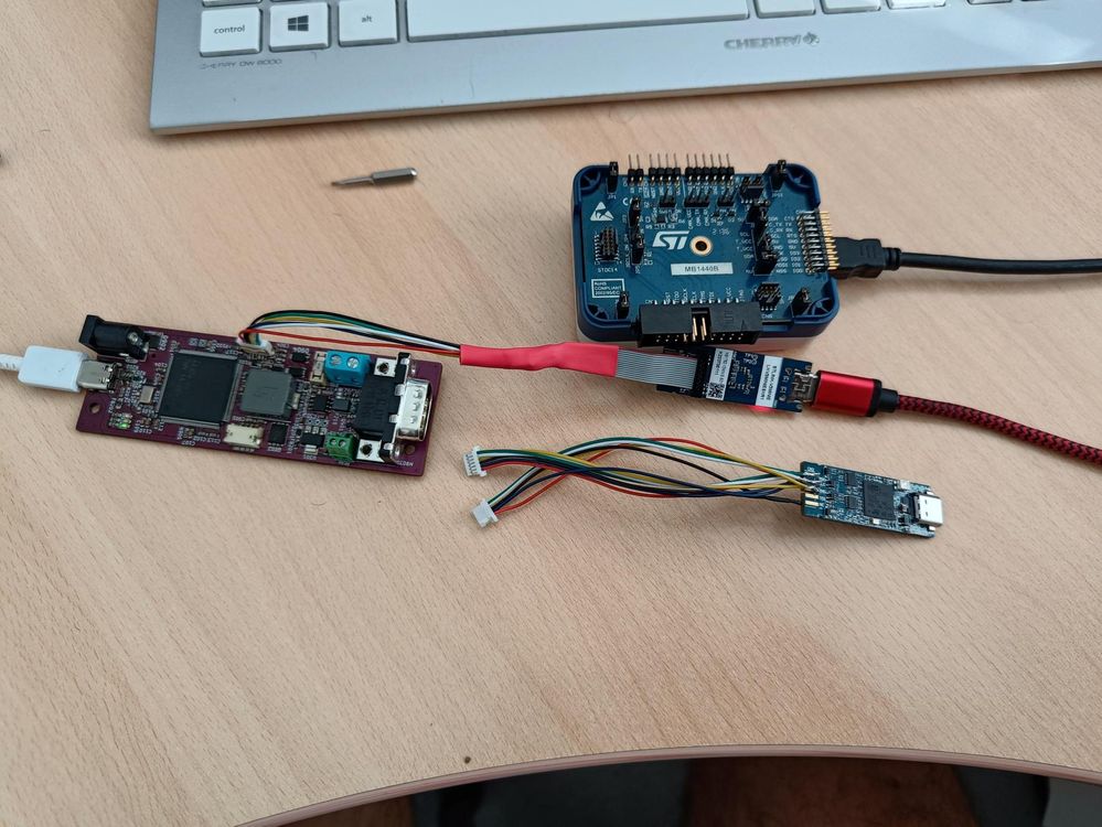

I had been using ST/Link 2.1 nucleo header so far to program and debug custom STM32 H723 ZG boards and wanted to switch to ST/Link v3 in order to debug with compact probes. Thus I ordered two genuine ST-Link/V3 MINIE from Mouser.

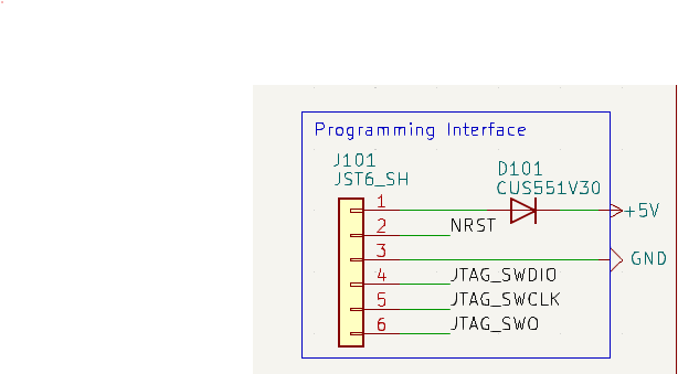

My custom board and debug connector is confirmed to be working since I can connect and program with STLink V2 and V2.1 .

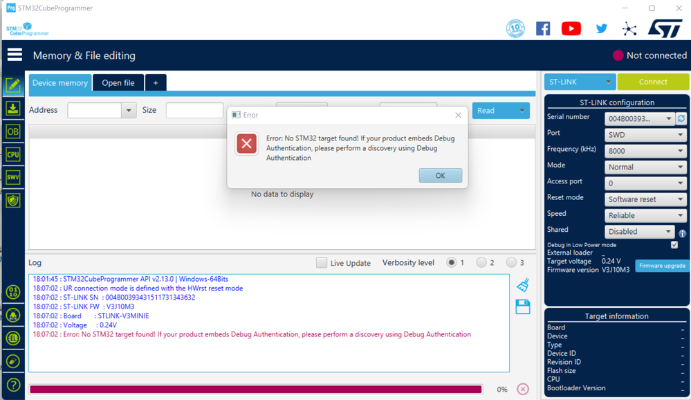

I've tried to connect through CN2 B2B connector as well a CN4 STDC14 Connector but I can not connect to the target via either method on both MINIE board I purchased.
I've updated firmware to V3J10M3, tried versions with and without Mass Storage. I've tried all Modes and Reset Modes.
Still I can not get target informations. Interestingly, CubeProgrammer states that the (target ?) voltage is 0.24V.
Wondering if there is an issue with my custom STD14 to JST-SH6 cable, i've tried to use a V3-SET with the very same cable and I can successfully connect to the MCU. Displayed voltage is 0.0V which is surprising because I get 3.25V with ST-Link V2.
My custom debug connector was designed for ST-Links V2s and only have a 5V input pad instead of 3.3v. So I can't power the board from the ST/Link. But since I power my board from an external USB, that shouldn't be an issue with the ST/Link V3 MINIE. Unless I am missing something.

Any idea why the genuine ST-Link/V3-MINIE are not working ??

Well, indeed if I provide 3.3V on Pin 1 (T_Vcc) of the MINIE, it reads 3.3V on voltage and can connect to target, but if I leave the pin floating it doesn't work. :thumbs_up:
So it means that the I/O shifters referenced on T_Vcc of the V3 MINIE absolutely need to be connected to 3.3V source while the V3-SET's can accommodate a floating T_Vcc pin ? How come ?
Ok, it partially explain where the (target) voltage information comes from on ST-Link V3 : basically an ADC reading the voltage of T_Vcc pin. But then how come the old ST-Link V2 were able to read 3.3v while this pin was not existing or wired ?
Also, do you thing I could bypass the Diode D101 from my boards, thus the I/O shifter will be inputing 5v (4.7V to be exact) from T_Vcc pin(1) and I can use my cable/programming connector as-is instead of adding a flying 3.3v reference wire just for ST-Link/V3 MINIE to work ? Usually ST32 hardware are 5V tolerant and I would expect the level shifter to be also tolerant, right ?

I don't think I'd use the 5V, you have a diode, find a 3.3V on the V3 MINIE
