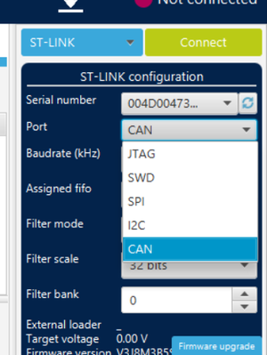

Is FDCAN Systembootloader described in AN5405
supported by cubeProgrammer or the CLI tools?
Because i only see the CAN (classic) option

Looks like a NO:  the ST-Link V3 does not support FDCAN - only CAN:
https://community.st.com/t5/stm32cubeprogrammer-mcus/stlink-v3-canbus-bootloader-over-stm32cubeprogrammer-problem/m-p/612597/highlight/true#M5538

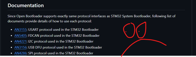

Im a bit confused howcome all examples for Openbootloader are supporting FDCAN and no CAN, i guess ill need to add CAN interface myself
