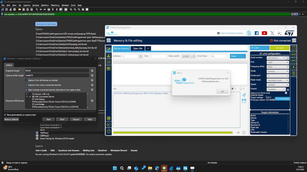

I implement Open Bootloader middleware to communicate USART protocol over USB CDC on Mbed OS 6
I found when I open STM32CubeProgrammer and click Erasing & Programming tab first time, program will freeze. But after first time does not freeze.
After Click Erasing & Programming tab. Program send Get ID for 100 packets per sec
Graph with 1 Sec interval, Get ID packets (I only filter 0x02)
Graph with 100ms interval, Get ID packets
Before Click, 2 Get ID per 1 sec
After Click, 513 Get ID packets with no delay
I also try with FTDI and result is mostly same
Graph with 100ms interval, Get ID packets 6-7 packet per 100ms
And also 513 packets
I also found when before and after buck send. Program change baud rate to 9600 and switch back to 115200 (I use 115200)

I don't know how to decode USB package. So, I filter using `f2:0c:fe:6f:ff:1f:01:00:00:00:00:00:00:00:00:00` This look like send every 1 sec. And behavior look like UART have 513 packets after click Erasing & Programming tab
Board: WeAct Studio STM32H743VIT6-0.96
With SWD I use `f2:0c:fe:e7:f1:1f:01:00:00:00:00:00:00:00:00:00` to filter. I think program only send 17 packets.
With USB DFU System bootloader. Normal send 2 packages per sec. After click I think 18 packets.

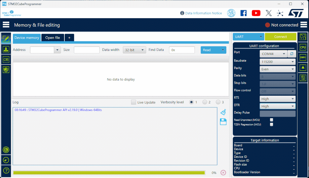

Could you please check, using v2.19.0, if this issue occurs only when first accessing the "Erasing & Programming" tab after launching the tool with verbosity level 3? From my testing, if the tab has already been accessed (with a different verbosity level) and is accessed again (even with verbosity level 3), the tool does not freeze, and I only see 2 packets/sec. Could you please check if this matches what you are experiencing?
Thank you in advance!
Maryem.
‎2025-06-03 6:56 PM
Hello @Maryem ,
I test with v2.19.0, L476VG, Windows 11 (24H2) 64-bit build 26100.4202
This problem still happens. ST-Link with >300 packets/sec will freeze for at least 2.5 sec
UART with ~100 packets/sec will freeze for at least 7.4 sec
