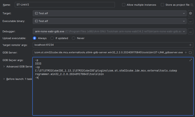

I am trying to use CLion to program STM32 MCUs as an alternative to other IDEs. For flashing and debugging, I want to use the Embedded GDB Server provided by ST, specifically ST-LINK_gdbserver.exe.
I prefer not to use OpenOCD because I have found it to be less stable for my use case.
The Problem:
I am struggling to find the correct configuration to make ST-LINK_gdbserver.exe work properly with CLion. I tried using a configuration I found in this GitHub issue:
Link: Official ST-LINK gdbserver support · Issue #354 · Marus/cortex-debug
However, when I try to run the GDB Server with this configuration:
I receive the following error:
C:\ST\STM32CubeIDE_1.13.1\STM32CubeIDE\plugins\com.st.stm32cube.ide.mcu.externaltools.stlink-gdb-server.win32_2.2.0.202409170845\tools\bin\ST-LINK_gdbserver.exe -p 3333 -cp C:\ST\STM32CubeIDE_1.13.1\STM32CubeIDE\plugins\com.st.stm32cube.ide.mcu.externaltools.cubeprogrammer.win32_2.2.0.202409170845\tools\bin -k

My Setup:
  • Board: Nucleo STM32F411RE
  • Toolchain: CLion + ST-LINK GDB Server
  • Connection: The board is connected via USB, and the ST-LINK firmware is up to date.
  • Project: Set up for the STM32F411RE MCU
What I don't understand:
The error message "Unknown MCU found on target" is confusing because the project is explicitly set up for an STM32F411RE, and the board is correctly connected. I have tested the board with STM32CubeProgrammer, and it connects without any issues.
Question:
What is the correct configuration or setup to use ST-LINK_gdbserver.exe with CLion? Are there any additional arguments or steps I need to add to resolve this issue?
Any help or insight is greatly appreciated!
Best answer by EniRot99
To summarize, the key steps to resolve the problem were:
  1. Ensuring that the port number is set to 61234 (default) for both the Target Remote Args and the GDB Server Args.
  2. Adding the programming interface in the GDB Server Args using the --swd flag, which might have been missing initially.
These adjustments seem to have resolved the issue effectively.

EniRot99AuthorBest answer
December 18, 2024
