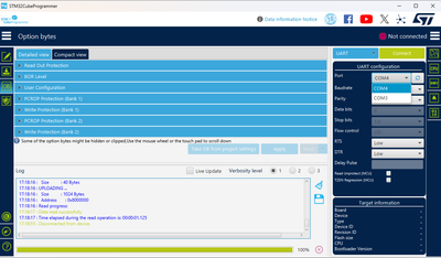

Phumphathai
Hello
I update to this version 2 day ago. Now I uninstall and reinstall with v2.19.0
I haven't found any new updates.
Maybe I update to Test on Production Version.
Thank you.

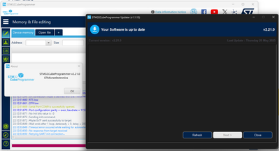

Hello
I use STM32L476VG with custom board. But without any board connect to USB to UART this still happen.
I use STM32CubeProgrammer v2.21.0 I think this is latest version

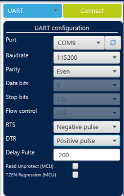

As @Pavel A. show. Delay Pulse text box is read only and cannot fill any value
Thank you
So, presumably, this must be coming from some configuration that you should supply?
And that value is missing or invalid.
The first message just tells you that it's using a default instead.
The rest of the video shows that there is no response from your target.

How can I supply?
Text box is read only. I cannot fill value. And it so annoys when I use.
Delay Pulse can be fill when RTS or DTS have set to pulse. But I don't want any RTS DTR pulse.
I show to connect without board. Invalid Delay Value Error still show. So, this does not depend on board I use.
Thank you

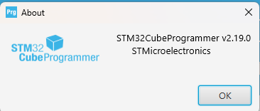

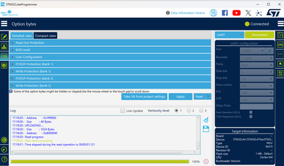

Hello @Phumphathai,
Could you please try to download the STM32CubeProgrammer from this link.
I'm using STM32CubeProgrammer2.19.0 version and Nucleo-L476RG.
I connect boot0(pin) to VDD as mentioned in AN2606.
And I'm able to connect board using UART
Thank you.
Kaouthar

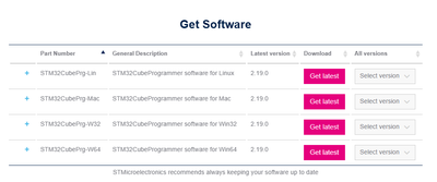

Where did you get v2.21.0 from?
The latest that I see that can be downloaded is 2.19.0 for all OS
