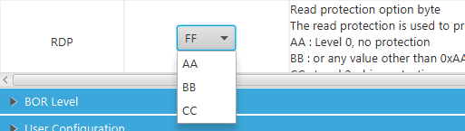

What ****** me off is the OB->RDP suddenly shows as FF (read protection), im unable to change it back to AA (no read protection).

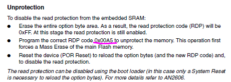

Reading the PM0075 Reading/programming the embedded Flash memory APP note now
it says the unprotect value should be A5 but the cubePRogrammer is trying to write AA..... maybe thats the key to unlock the mcu?

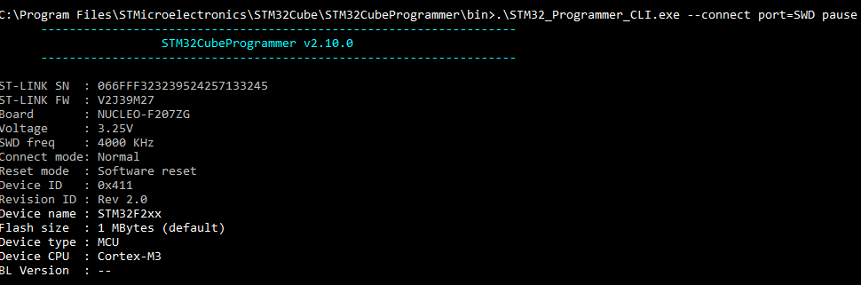

Connecting via SWD
STM32_Programmer_CLI.exe -c port=SWD

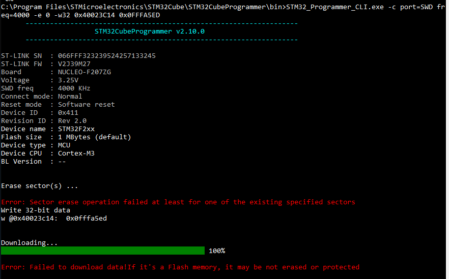

Writting into the OB bytes
STM32_Programmer_CLI.exe -c port=SWD freq=4000 -e 0 -w32 0x40023C14 0x0FFFA5ED
NAh it didnt work....

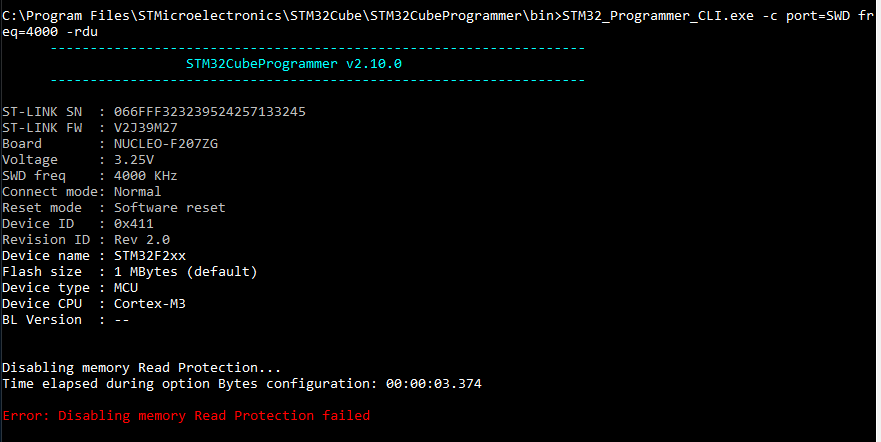

‎2022-12-01 9:21 AM
Disabling memory read protection didnt work either.
STM32_Programmer_CLI.exe -c port=SWD freq=4000 -rdu
or
STM32_Programmer_CLI.exe -c port=SWD freq=4000 --readunprotect
same thing happened to @GYacc​ https://community.st.com/s/question/0D53W00000JMwCbSAL/disabling-memory-read-protection-failed

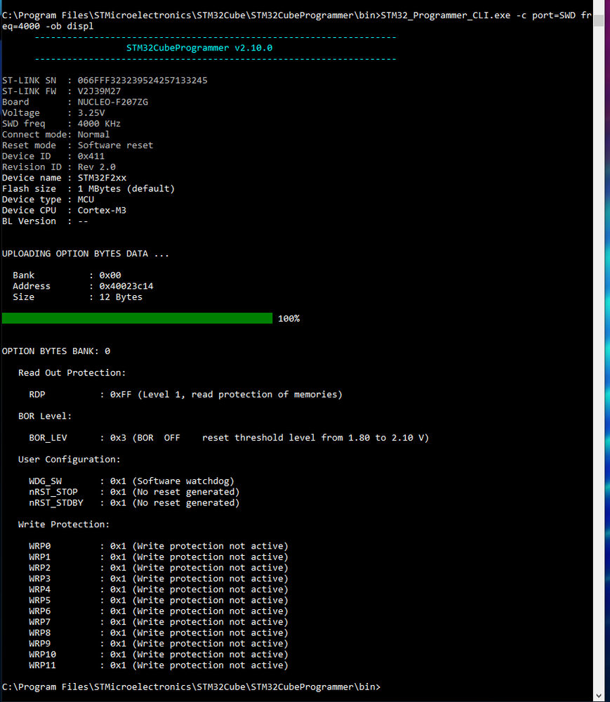

‎2022-12-01 9:26 AM
Displaying OB , not what i want but it shows RDP still being 0xFF
STM32_Programmer_CLI.exe -c port=SWD freq=4000 -ob displ
