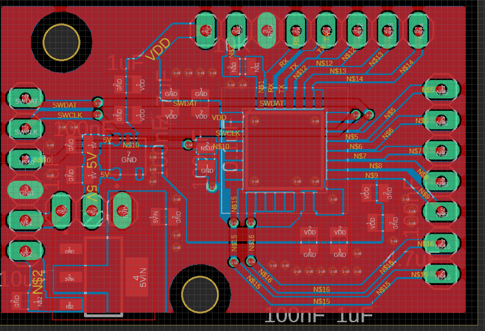

made my own board with stm32g431kb and accidentally disabled swd. I can't acces my board anymore and pulling up boot0 doesn't help.

show us how youre connecting the SW pins, do you connect the reset line from the stlink to your board?

I can't connect the reset line both to the stlink and manually pull it down. but i tried both. it's a custom board but here is a picture. yes it worked fine the first time with both my boards ( I made two) . but after that, they both didn't connect anymore. then i saw i forgot to check the swd debugging pins in ide. i just connect the swd and swclock to the swdio and swclk of the stlink.

If you didnt break anything, you should be able to programm the mcu even without SW active in your previous code.
Just do one of them not both at the same time.
