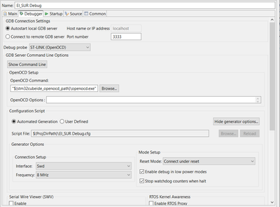

Sethnittu
This is my debugger setting.
waclawek.jan
Single-step the program in debugger.
When stopped, read out and check/post GPIOB registers content. Try to toggle the LED manually by writing to GPIOB_ODR in debugger.
