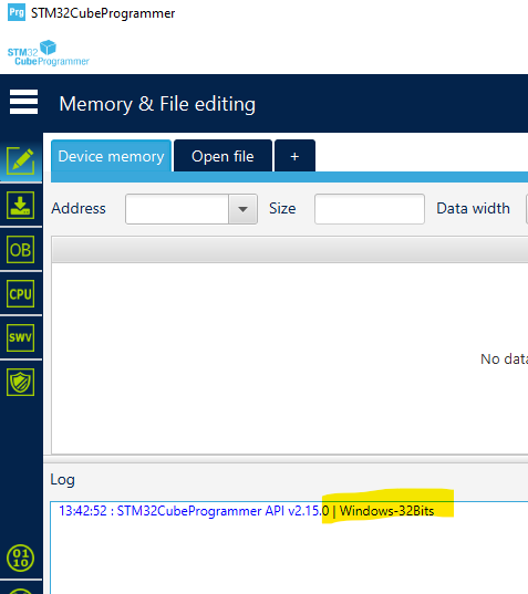

FArdi.1
I'm not sure if this information will help ST to figure out the problem.
Everything was working fine few months back with version 2.12.0.
Recently I saw latest version 1.15.0. I updated CubeProgrammer to this version.
Right after finished installation of 1.15.0, there's popup message saying I need to agree about sharing statistical data or something (not sure the exact words).
I click Ok button or agree button, but nothing happen. I have to force close using Windows task manager.
The next time I go into the CubeProgrammer, until now, the blue page shows for one second, then automatically closed.
FArdi.1
I just found the workaround: Install 32bit version of STM32CubeProgrammer.
My laptop and the Windows OS is 64bit, so I normally install the 64bit version of STM32CubeProgrammer.
I don't feel difference using 32bit version. It does the basic job that I need (erase, download to MCU, verify).
