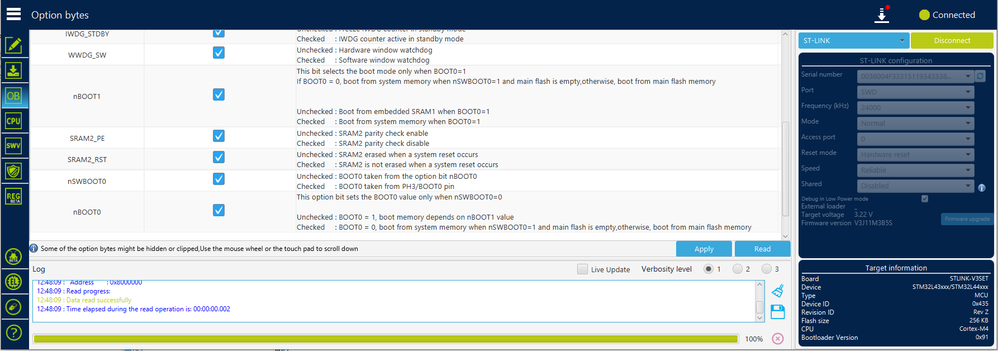

My boot options are all checked:
The Bootpin BOOT0 (PH3) is connected to GND via a 10k resistor.
Do I missed something, that the bootloader does not response?

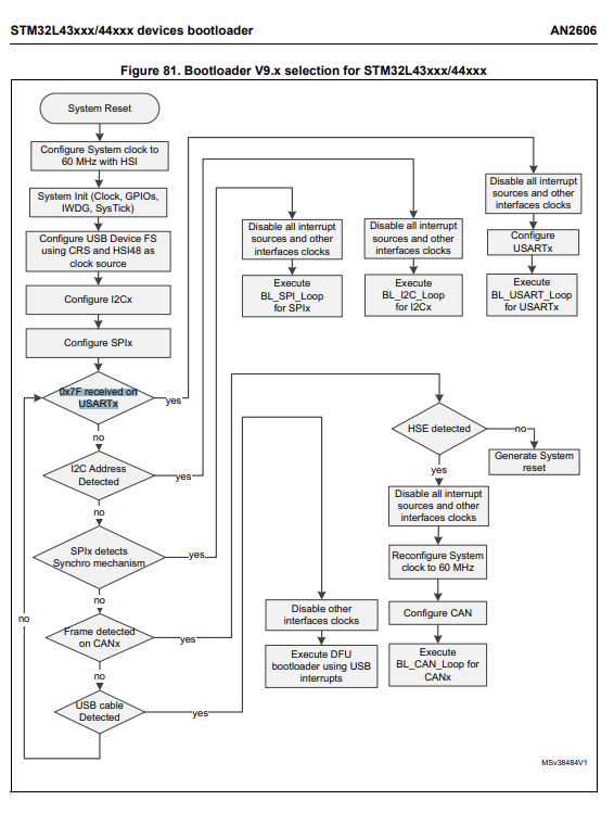

Switch in Cubeprogrammer connect to USART and try connect
And primary read AN2606 diagram about interface detection order and check if no other interface is detected .

According to AN2606 USART is the first interface to check.
‎2023-04-22 11:23 PM
Interfaces is checked in loop. Quickest as you 7F if other is detected...
Check your connections...

Are the boot option bits set correct? Or do I have to change something before jumping to bootloader?
