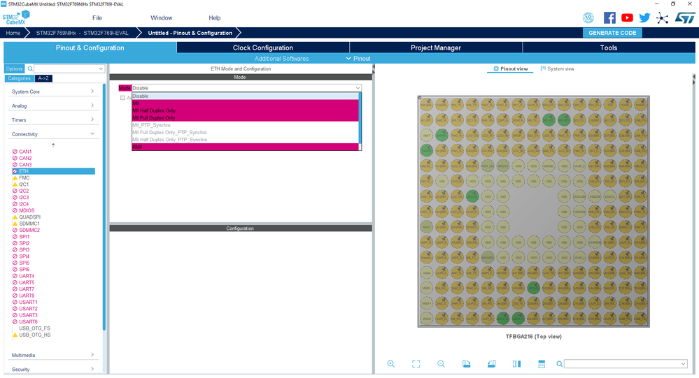

I too am evaluating the F7 (actually H7 but we can't get hold of an eval board) for an upcoming project. CubeMX sounded great on paper, but unfortunately it hasn't lived up to the marketing hype. My first demo project used ST's flagship evaluation board - STM32F769I. After loading the package into CubeMX and accepting the defaults I noticed nearly all the peripherals had conflicts. I set my self the task to get the Ethernet HAL enabled. Hours later I'm still no closer. I have disabled every peripheral on the board and yet it still complains about conflicts. Unless they are resolved, it doesn't allow you to link in the TCP/IP stack (LwIP) which is the whole point.

Please try again with a new project, but do not choose the default values to initialized the peripherals.
See the attached picture below. It is possible to enable the LWIP Middleware without any conflict.
‎2019-04-22 7:37 PM
Hi Alex, thanks for your reply. I should have been more precise. I'm using the Evaluation Board STM32F769I-EVAL. I can see the discovery board does work like you said. However the STM32F769I-EVAL board starts out like this:
I think it has something to do with the FMC address/data lines taking up too many pins. I might have more luck if I start with just the micro (not board) and build the configuration up myself instead of taking things away from the board configuration.
I got Ethernet working on my little Nucleo144 board. There were a couple of gotcha's. The main one was with the tx/rx descriptors being cacheable. It appears DMA and the cache on the F7 don't play well together. Anyway, once they were made non-cacheable it all worked great.
