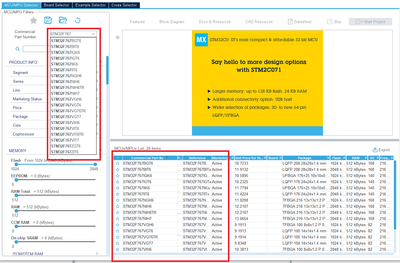

This is a screenshot of CubeMx showing a list of STM32F767 MCU part numbers:
Hope that answers your question.
