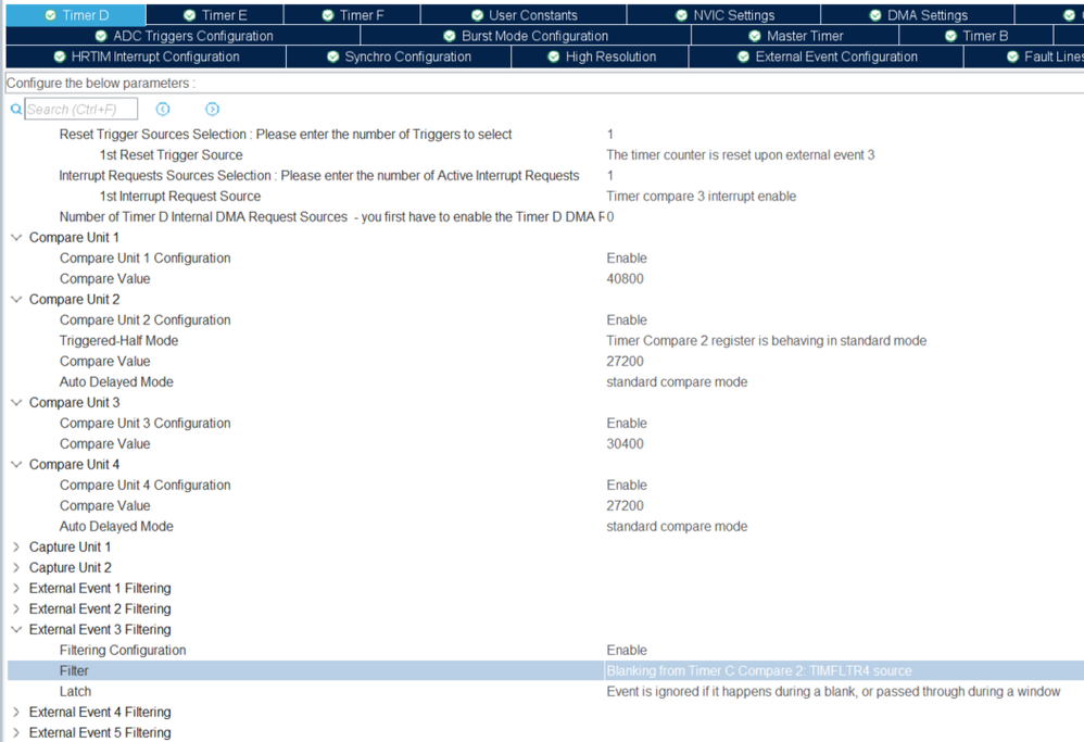

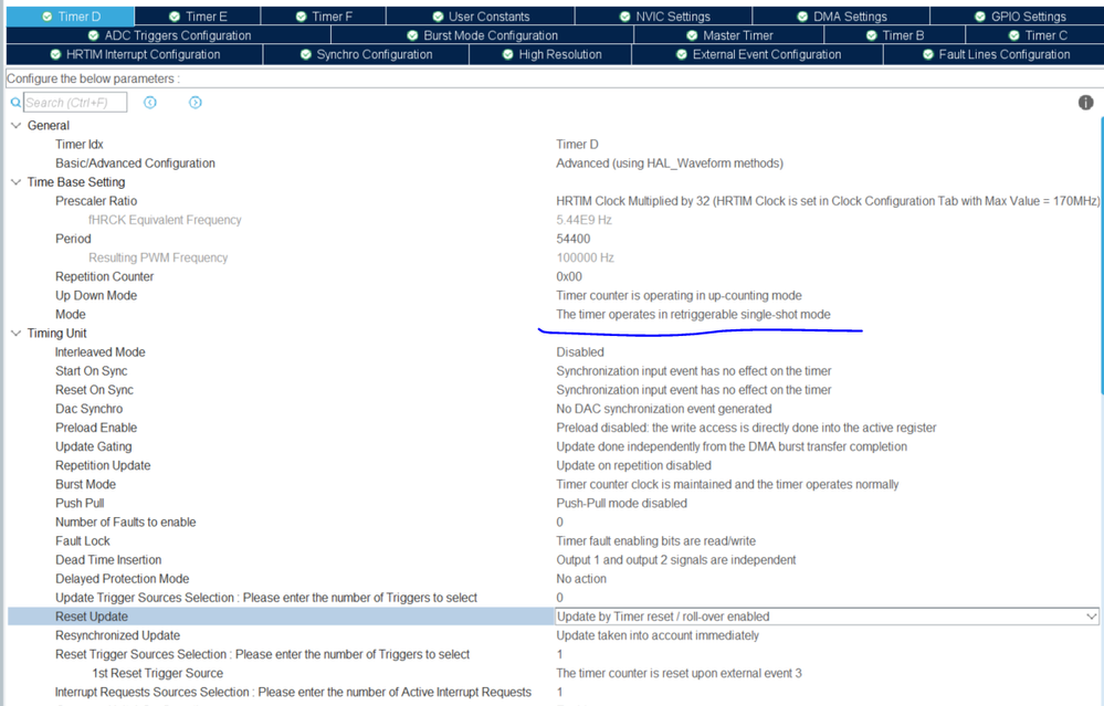

Why STM32G474 HRTIM TIMER D doesn't work when event filter blanking window enabled?
Options
2022-11-08 6:27 PM
when timer mode set as single shot, the timer will not run, but if the event filter is disabled, it can run normally.
when event filter enabled, timer mode set as continuous mode wiill run normal.

Hi @HCai.1
To be able to push further the analysis could you please provide your ioc-file, in order to reproduce the issue with your exact configuration.
I'll be waiting for your feedback.
Thx
Ghofrane
