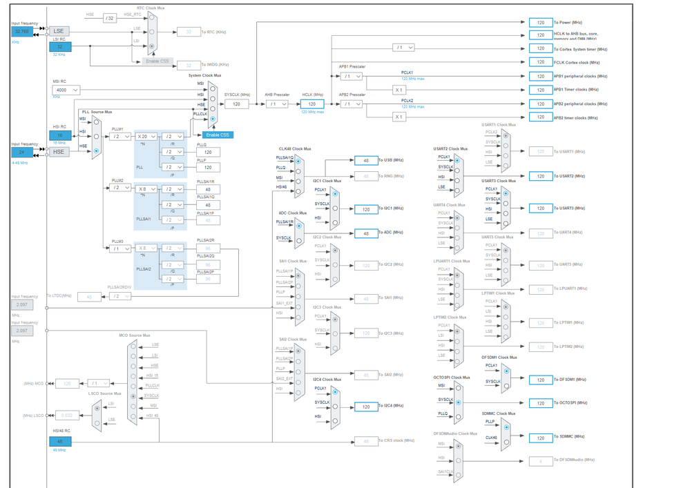

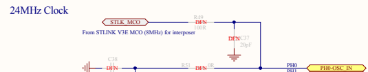

Why my LED PG13 does not light up when I use the external crystal, but it does when I use the internal crystal, what went wrong? I initialized in cubeMX, debugged and burned in keil

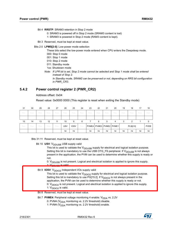

VDDIO2 pin is connected?
Is PWR_CR2.IOSV bit set?

To use GPIOG bank pins there must be a VDDIO2 supply and you must explicitly enable it in your code somewhere. ​

waclawek.jan
PWR->CR2 |= PWR_CR2_IOSV;
Or, as an experiment, look at the PWR_CR2 register in the debugger and click there to set the IOSV bit.

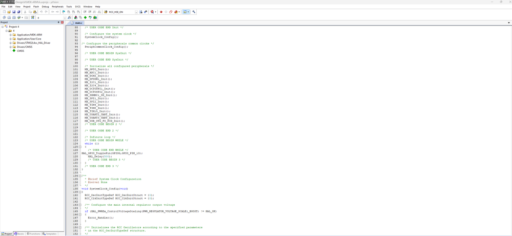

https://community.st.com/s/question/0D53W00001rApk7SAC/about-gpio
  /* VddIO2 must be enabled to access GPIO port G[2:15] */
  __HAL_RCC_PWR_CLK_ENABLE();
  HAL_PWREx_EnableVddIO2();
  __HAL_RCC_GPIOG_CLK_ENABLE();
Where you initialize the pins, or in SystemClock_Config()

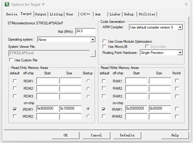

AScha.3
on STM32L4P5G-DK is no 24M crystal , clock is 8M from onboard stlinkV3 :
_legacyfs_online_stmicro_images_0693W00000bk1IQQAY.pngso set "bypass" clock and 8 MHz . then try ...
