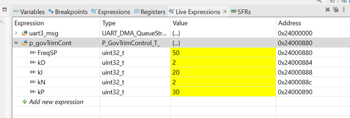

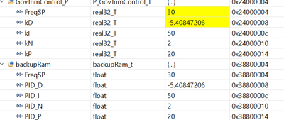

I have a functioning project that fully compiles with only three warnings, but when I debug it and examine C structures in the live expressions viewer the the data (GovTrimControl_P structure ) appears to be offset by 4 bytes, yet the memory browser shows the correct values and when the mouse hovers over a value that value is correct:

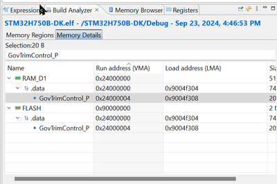

The Build Analyser also reports the address of GovTrimControl_P  correctly
Compile Problem Output:
The values for the GovTrimControl_P structure are set at bootup to:

The problem also occurs with another constant array where the Live Expression viewer reports incorrect framing of the underlying data.
I am running STM32CubeIDE Version
Version: 1.16.1
Build: 22882_20240916_0822 (UTC)
On an STM32H750B-DK Discovery kit,
I have attached the Linker Script File, startup file and video in the hope this might shed some light on the issue. The video shows the Backup ram memory which has the GovTrimControl_P data copied into it. The data shows the correct framing in the browser, but not in the Live Expression viewer:

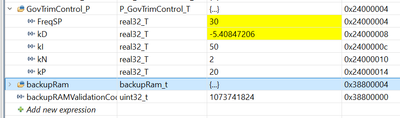

 The backup ram copy function and its use are shown below:
void backupRamStartup(uint16_t bypassBtnState,
uint32_t code,									uint32_t* ramCode,
void* ramAddr,
void* parameters,
uint16_t size)
	if((bypassBtnState == 1) || (*ramCode != code))
		/* The user is setting the defaults or the backupRam is empty */
		*ramCode = code;
		memcpy(ramAddr, parameters, size);
		return;
	/* The backup ram contents are used to set the parameters*/
	memcpy(&parameters, &ramAddr, size);
/* Useage */
backupRamStartup(  								        HAL_GPIO_ReadPin(PC13_PB_DEFAULT_SET_GPIO_Port,
PC13_PB_DEFAULT_SET_Pin),
0xC0AD1234,
&backupRAMValidationCode,
&backupRam,
&GovTrimControl_P,
sizeof(GovTrimControl_P));
I have never seen this occur in any of my other similar projects with older versions of the IDE.
Has anyone else seen this problem

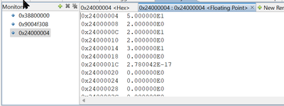

I made a very small project with the same data structure as GovTrimControl_P and the mis-framing did not occur.
I then thought maybe the data appeared misaligned to the IDE which only happens with a big project so I added __attribute__((__aligned__(4))) to my variables and voila it is fixed.
backupRam_t __attribute__((__aligned__(4))) __attribute__((section (".VBAT_SRAM"))) backupRam;
And
P_GovTrimControl_T __attribute__((__aligned__(4))) GovTrimControl_P =
  /* Variable: FreqSP
   * Referenced by: '<S1>/Constant'
  50.0F,...
Of course the data isn't misaligned as the data are floats, the IDE just thinks it is.
So there is a bug in the IDE, that only seems to appear in non-trivial projects.
Adding the alignment seems to work so All is Good.
The problem re-occured so it seems the attribute  aligned isn't the answer.
