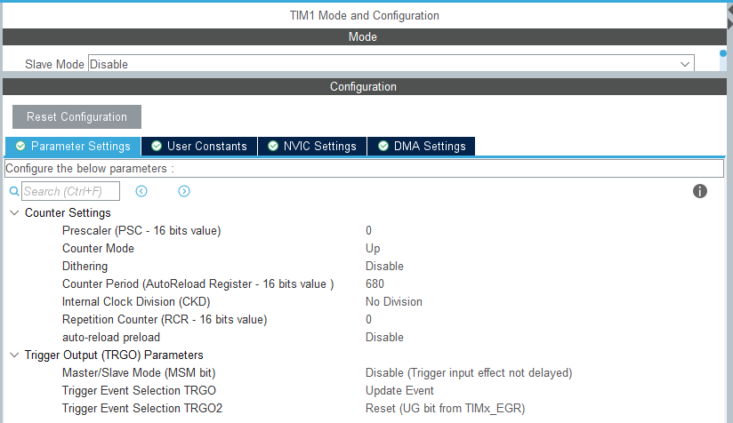

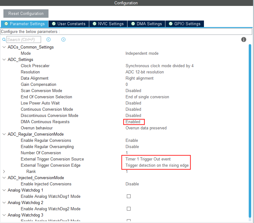

Using DMA1 channel 1, copy the data collected by the ADC during half transfer interrupts and transfer complete interrupts.Discovered that half transmission interrupts and full transmission interrupts cannot be used independently.

Yes,you are right.I used a timer to trigger the ADC.And in IRQ,check for HT being enabled & being set  has been resolved this bug.
