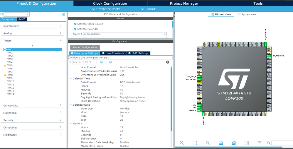

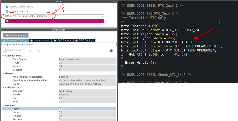

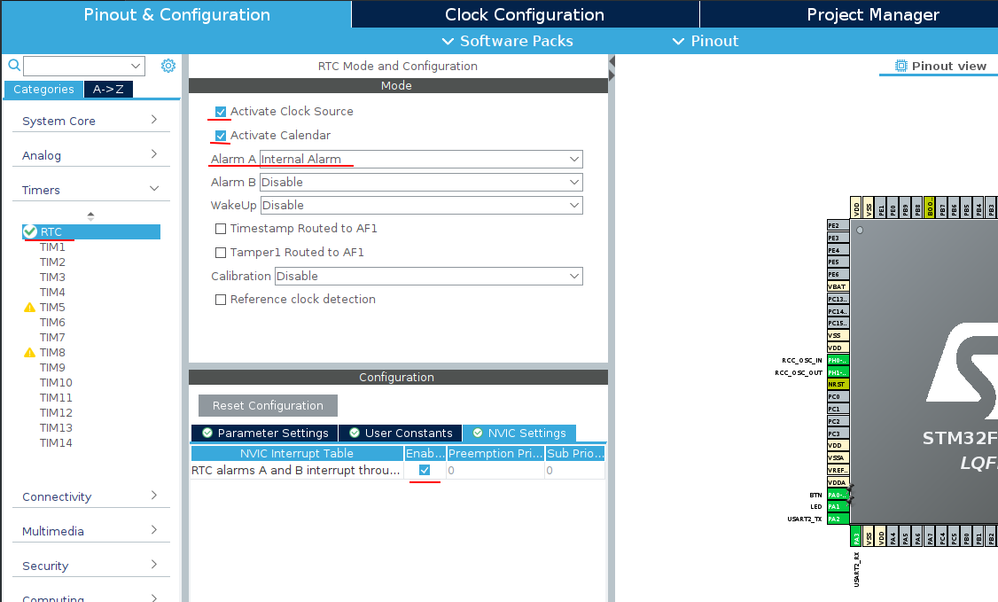

2021-10-19 8:56 AM
I think the reason why my alarm clock do not work, it is because, I do not have some setting!?!? see screenshot.
And so I have "RTC_OUTPUT_DISABLE" in my the code.
If I'm right, how to fix it is?

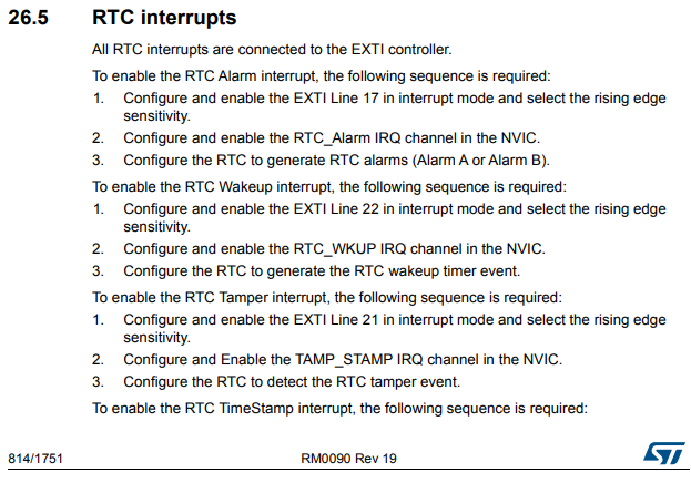

Have you connected the EXTI line 17 to the RTC Alarm event ?
Did you set the following sequence correctly? (to enable the RTC Alarm interrupt)
Thanks
Imen
2021-10-19 10:56 AM
No, and I do not know how to do it!
