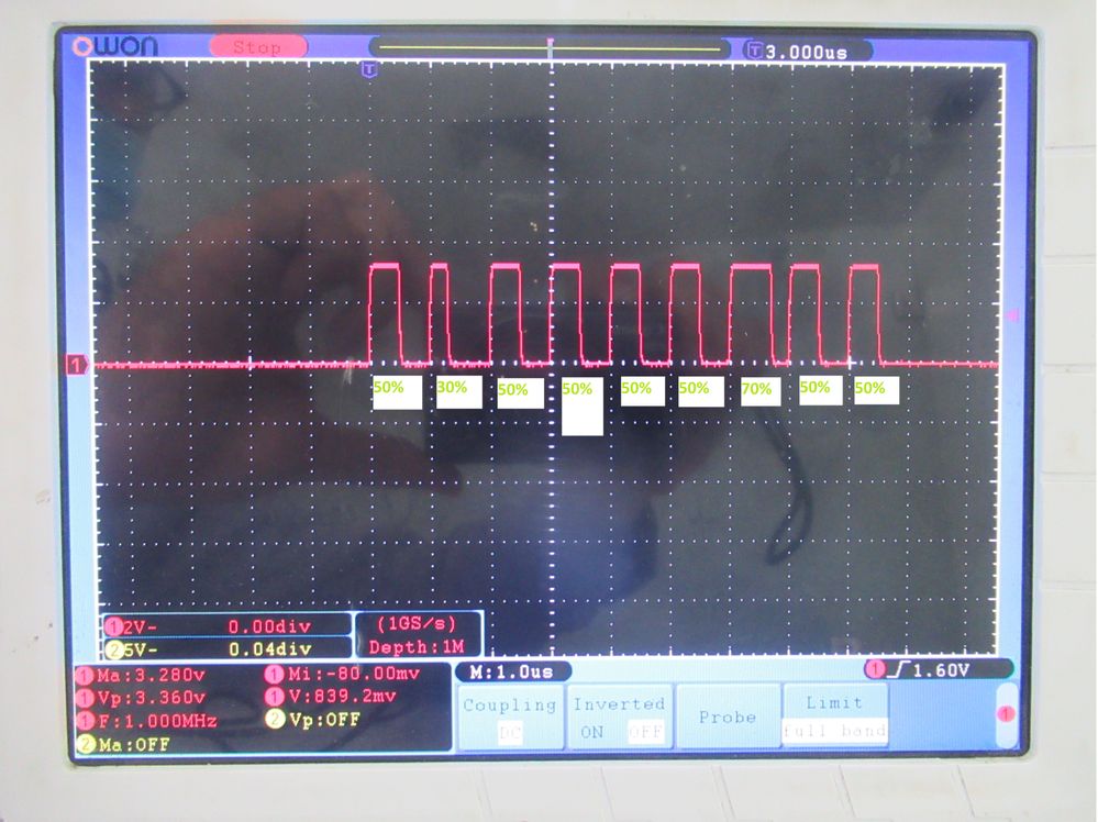

I generate 7 pulses with frequency 1Mhz and duty cycle of pulses is 50,30,50,50,70,50,0% sequence.
But the result have some issue:
  1. On my OSC, i see 9 pulses and it more than i need.
  2. The 50% pulses repeat 4 times before and after the 70% pulse.
I don't understand why !
>>> Signal on my OSC:

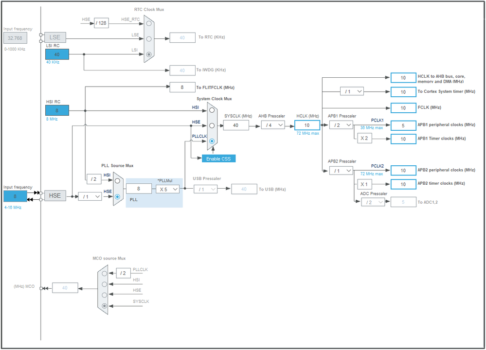

0693W00000FCxW5QAL.pngSys clock=40Mhz, Timers clock=10Mhz

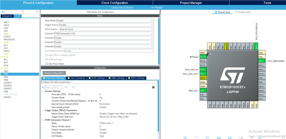

0693W00000FCxY1QAL.pngPWM config

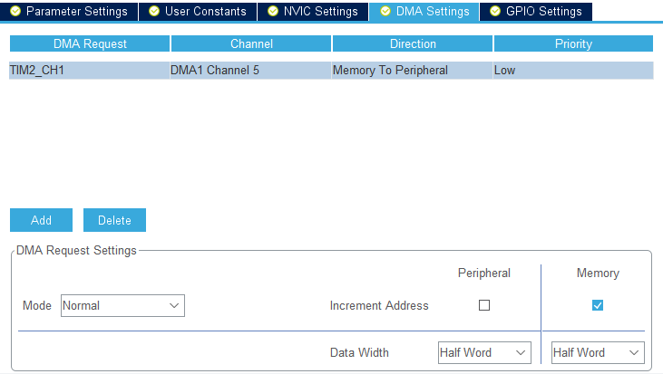

0693W00000FCxZsQAL.pngDMA config

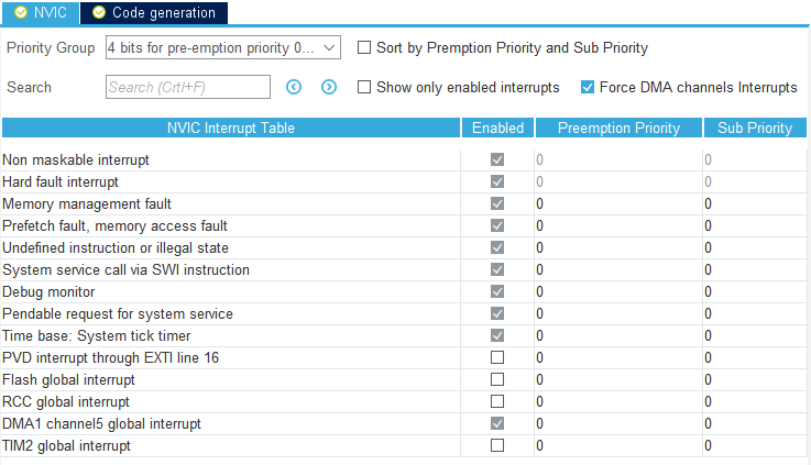

0693W00000FCxbKQAT.pngNVIC by default

IMO this is simply DMA not succeeding to fill the new value to CCRx in timely manner. Try increasing system clock frequency, or set APB divider to 1, or both.
Hi JW, thank you for your reply.
Could you show me the documents or application note talk about "DMA not succeeding to fill the new value to CCRx in timely manner" ?
I want to learn more.
BR!
waclawek.jan
Read AN2548.
