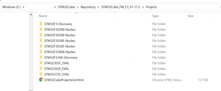

You can install the STM32Cube MCU package for F3 series ( or for other series). This package comes with a rich set of examples running on STMicroelectronics boards. The examples are organized by board, and are provided with preconfigured projects for the main supported toolchains:
You'll find a table resuming the available examples in the STM32Cube firmware examples for STM32F3 Series Application Note.
Noting that there is no STM32CubeMX project for those examples.
