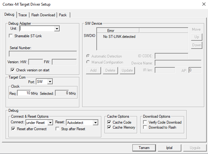

‎2022-04-16 1:45 AM
Is this configuration true?
I have chosen connect under reset and I want to debug with StLink V2.
