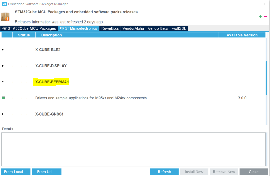

Which version of STM32CubeIDE supports managing X-CUBE-EEPROM with "Embedded Software Packages Manager"?
SOfne.1
Mikrocontroller: STM32L5
IDE:
  1. STM32CubeIDE v1.3.0 with firmware package STM32Cube_FW_L5_V1.2.0
  2. STM32CubeIDE v1.5.1 with firmware package STM32Cube_FW_L5_V1.3.0
I tried both IDE versions but didn't find a way to import X-CUBE-EEPROM into the "Embedded Software Packages Manager". When trying to import zip file en.x-cube-eeprom.zip with "Embedded Software Packages Manager" via "From Local ...", I only get the error message that a "Problem during load of selected File" occurs (see attachment). And unlike other expansion software for Cube (e.g. X-CUBE-ALGOBUILD, X-CUBE-MEMS1, ...) X-CUBE-EEPROM is never mentioned in the latest STM32CubeMX release notes.

Thanks for raising the question,
The EEPROM pack is named with X-CUBE-EEPRMA1 and it's available on CubeMX 6.2.0 Version.
0693W000008xFGnQAM.pngIf you still face a problem don't hesitate to post it, I'll be waiting for your feedback :)
Thanks, Khouloud

I had a quick look at X-CUBE-EEPRMA1 but it seems not to be the same as X-CUBE-EEPROM: https://www.st.com/en/embedded-software/x-cube-eeprom.html
My goal is to emulate an EEPROM within the internal flash of a STM32L5 as described in AN4894.
Unfortunatelly, an external SPI EEPROM can't be used.
