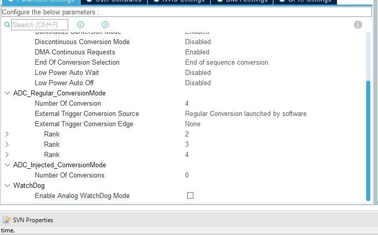

I try to set, using last version STM32CubeIDE, the ADC to get 8 analog inputs, using DMA, with permanent conversion.
  • I doesn't see anymore the rank 1 ? (see picture)
  • When I start HAL_ADC_Start_DMA, i have only the AN0 value, and only 8 bits (I set12bits in parameters), and not refreshed (only one conversion). [HAL_ADC_Start_DMA(&hadc, (uint32_t*)adc_buf, ADC_BUF_LEN);] adc_buf is uint16_t array type.

lclor
lclorAuthor
May 25, 2022
hello,
All my software and packages are up to date. And I didn't migrate from older version.
I have now again the Rank N°1, I have disabled all INXX, then enable again, and the Rank N°1 is now visible. I couln't give you detail scenario to make the rank N°1 not visible, because I made a lot of tries with ADC settings to try to make it running with DMA.
But I think there is an issue with STM32CubeIDE for this point.
Best regards,
Laurent
