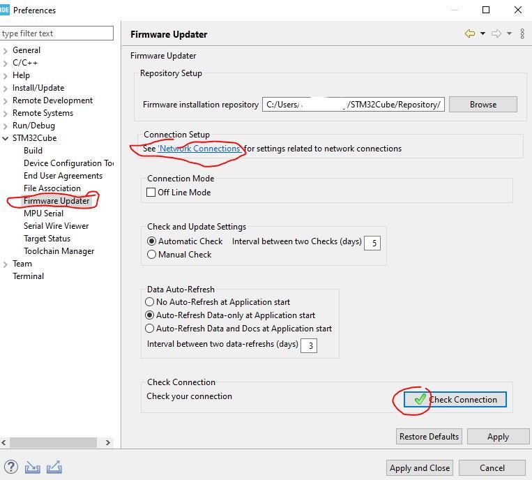

Definitively automated way of working is:
1) Rely first on FW setup settings/ Windows > Preferences > STM32Cube > Firmware Updater
Rely on Check connection button to verify your settings are fine: green check is required.
Note here you have some hyperlink to proxies setup & FW packages install repository setup.

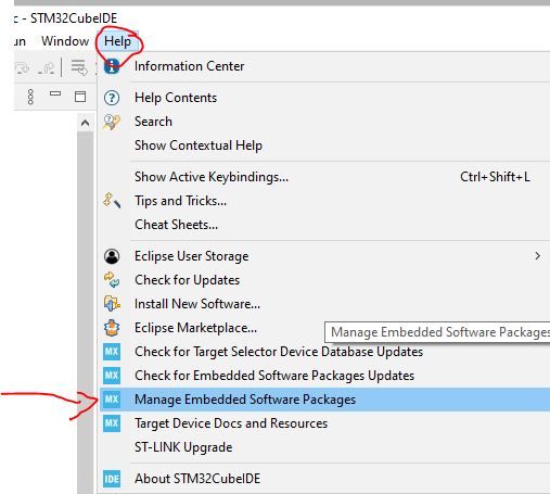

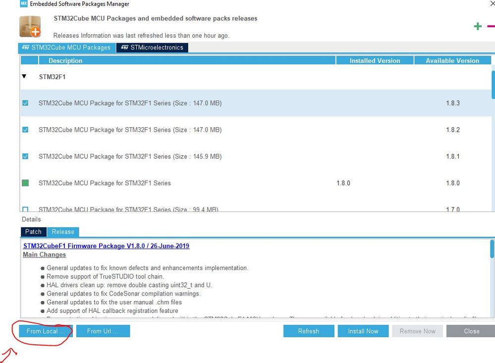

0693W000005CSw2QAG.jpg2) Once ok
Then if not working (???) handmade install can be done for sure. Rely on www.st.com (or github) to get archive of such FW packages.
Still Help > Manage Embedded Software packages is right place for.

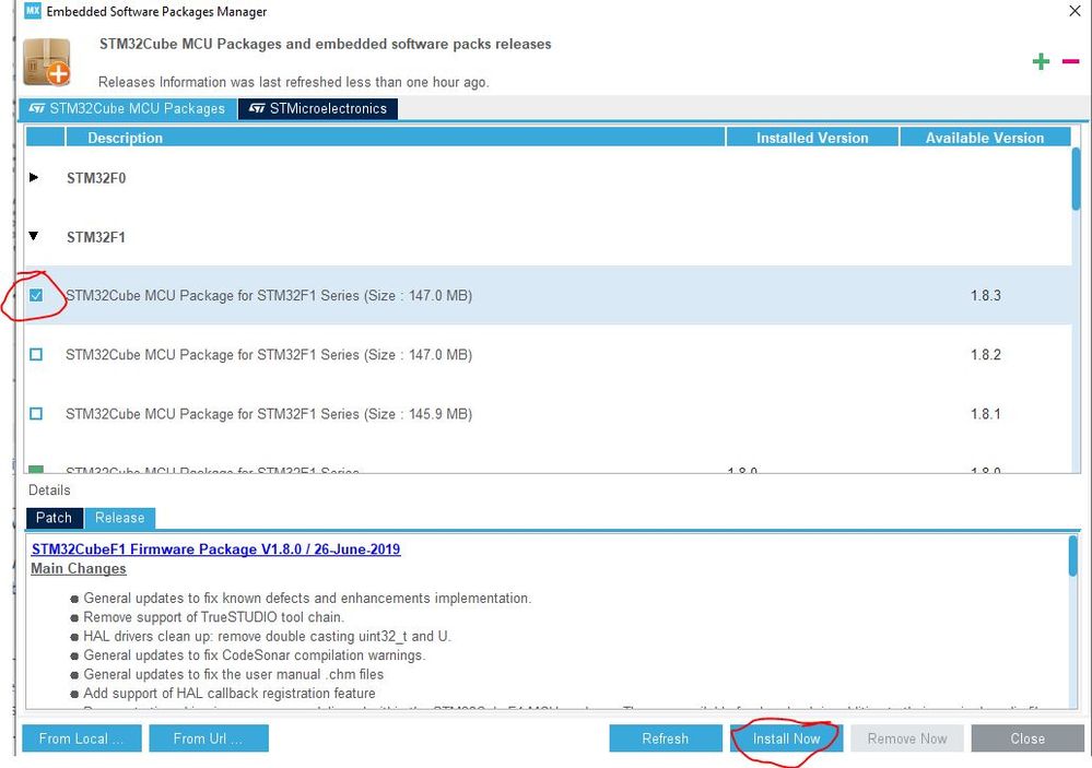

Being safe I would proceed here following 4 steps:
a) Remove any existing local trace of your F1 FW pack (see prevoius preferences sanpshot considerign FW packages install repository)
b) I would retrieve 2 archives. F1 1.8.0 master one then pacth 1.8.3 one
c) I would install first 1.8.0
d) Finally I would install 1.8.3
You have to be aware 1.8.3 archive is not self contain. Here you're only getting a patch to be applied on top of 1.8.0. (I full automated install process is working such is taking care for you about such dependencies hopefully)
