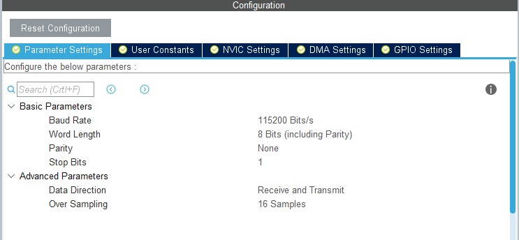

I am using STM32F412CGU6 MCU.
I want to configure USART1 as Half Duplex mode (Single wire mode) with TX only and below configurations:
- Baud-rate = 115200
- Start bits = 1
- Parity = even
- Data bits = 7
- Flow control = off
- Stop bits = 1
But in STM CUBEMX , "Start bits" can not be set/configured. Check attached snapshot for reference.Can you please suggest the way/ code changes for configuring the USART1 with above settings?

UART always sets one start bit. No need to configure!
