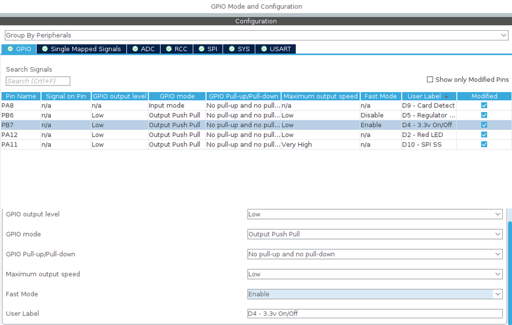

What is "Fast Mode" of a GPIO Output and why do only some pins have it?
CKugl.1
Senior II
STM32CubeIDE Version: 1.6.1 Build: 9958_20210326_1446 (UTC) (C) 2021 STMicroelectronics ALL RIGHTS RESERVED
Device: NUCLEO-L412KB
0693W00000GWsgdQAD.pngIn Device Configuration Tool, Pinout & Configuration, GPIO Mode and Configuration, for a GPIO Output, what is the meaning of the "Fast Mode" field, and how is that related to "Maximum output speed"? Why is it n/a for port A pins but available to Enable/Disable for port B pins?

This is probably to switch on the I2C Fm+ capability, see SYSCFG_CFGR1.I2C_PBx_FMP.
Not that that one is explained properly in RM and DS, but unless you intend to use I2C in Fm+ mode, you can leave it at its reset default value safely.
It is used to enable fast mode for I2C on a per-pin basis by calling HAL_I2CEx_EnableFastModePlus.
The source code actually explains why it's only available on particular pins decently well.

waclawek.jan
First, CubeMX ought to hint that this is I2C/Fm+ specific feature.
Second, a random "library" is not the place for documentation. RM/DS/AN are.
Third, RM nor DS explains, what *exactly* is enabled by SYSCFG_CFGR1.I2C_PBx_FMP and SYSCFG_CFGR1.I2Cx_FMP bits. Per I2C specification, difference between Fm+ and Fm is only in the drive capability (plus receiver timing tolerance for backward compatibility, but that is unrelated to pins). DS specifies FT_f pins to sink 20mA unconditionally. So what gives.
Fourth, RM fails to explain, whether the feature enabled - whatever it is - is related to pin structure as such, or is I2C specific. In other words, it ought to explain, whether that feature is or is not subject to given pin being set as AF in GPIO_MODER and set to the given I2C's AF in GPIO_AFR.
Fifth, RM fails to explain, what exactly is affected by SYSCFG_CFGR1.I2Cx_FMP bits bits (pins affected by individual bits ought to be listed there).
