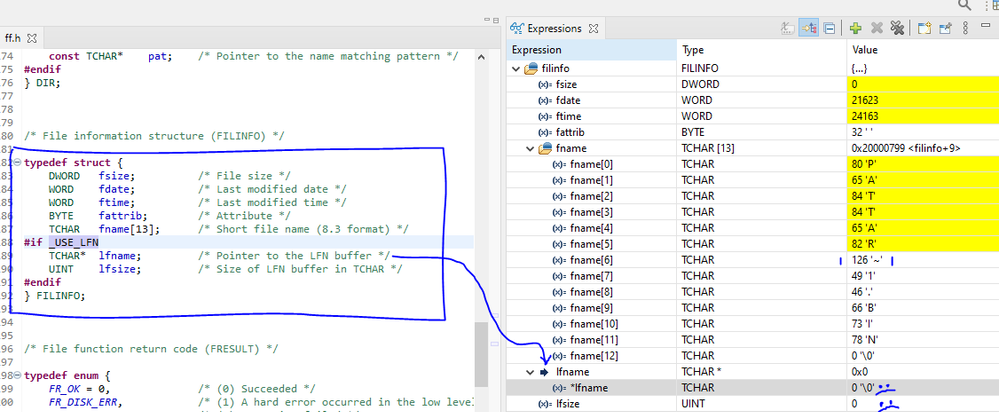

Using FatFs , i am unable to get long filenames, but i get the short filenames
Javier1
Principal
I am able to read the fixed length fname.
But the pointer to the long filename is always 0.
this is how im reading trough the list of files
FRESULT detect_binariesFolder(){
	fresult=f_opendir(&dir, "lu");
	fresult=f_readdir(&dir, &filinfo);
	fresult=f_findfirst(&dir, &filinfo, "lu", "*.bin");//http://elm-chan.org/fsw/ff/doc/findfirst.html
	   while (fresult == FR_OK && filinfo.fname[0]) {         /* Repeat while an item is found */
			fresult=f_findnext (&dir, &filinfo);
	fresult=f_closedir(&dir);
	return fresult;

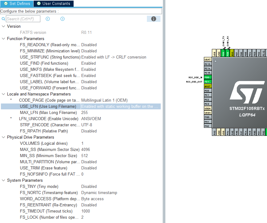

I tried the three different cubeMx options for long filenames :
  • static buffer on the BSS
  • dynamic buffer on heap
  • dynamic buffer on stack
None of them works.
My setup:
  • stm32f105RBt6 custom board.
  • SD Card trough SPI2, sandisk ultra 16GB.
  • CubeMx version 6.4.0, STM32Cube_FW_F1_V1.8.4 package which uses FatFs version R0.10c, Nov 09, 2014.

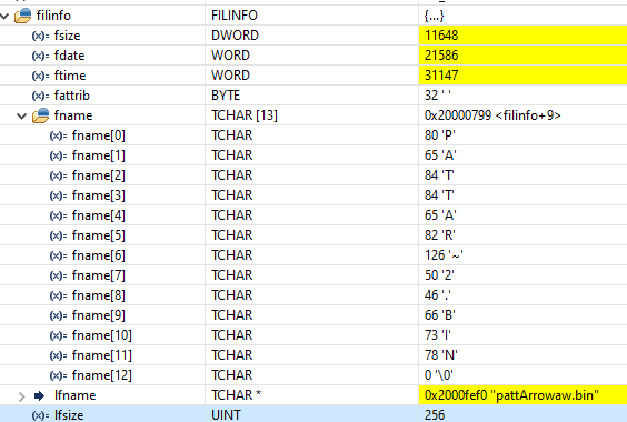

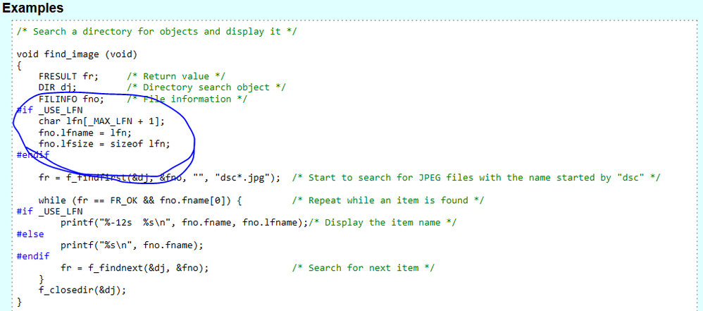

Okay that wasnt so hard, i just needed to find up to date documentation.
(C:\Users\**your user**\STM32Cube\Repository\STM32Cube_FW_F1_V1.8.4\Middlewares\Third_Party\FatFs\doc)
Apparently the pointer needs to be initialiced by you first.
adding this three lines fixes the code:
    char lfn[_MAX_LFN + 1];
    filinfo.lfname = lfn;
    filinfo.lfsize = sizeof lfn;
    	return fresult;
