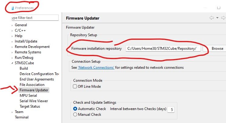

Maybe such is helping you:
0693W00000LzJXPQA3.jpgThis way you can set your own global local repo if FW packs. But I would recommend to point on expected FW pack release.
You have many ways thru file system to force version you want but part of your own risk then. It may perfectly work or not ... depends on IPs you're relying on etc etc ...

My use case is: no internet access to the ST servers (corporate network, firewalls, ...) and the firmware repository is on some centralized local server with a non-default path.
Moreover, the feature is present in CubeMX and STM32CubeIDE claims (about box) to integrate

Btw, you can pick older firmware release in CubeIDE, this works. Only the path entry missing.

That a valid workaround, thanks
