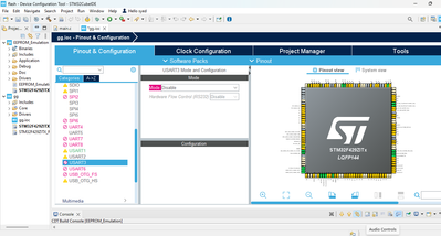

USART3 selection disabled in CubeMx
‎2024-11-25 4:39 AM - last edited on ‎2024-11-25 4:49 AM by mƎALLEm
I need UART to use printf, but it's showing as disabled. How can I enable it, and I also need an example code for printf.

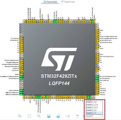

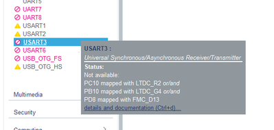

If you pass the mouse on USART3, you will get the warning and the information about the issue:
There are IO conflicts with FMC or/and LTDC.
So you need to go to the pinout view and type USART3. All USART3 pins will toggle. Then select the pin that you need to use for UART3.
Attached a project where I configured USART3 on PB10 and PB11.

‎2024-11-25 4:48 AM - edited ‎2024-11-25 4:50 AM
Again, please put a correct title for your posts. "uart" doesn't make any sense.
For your question: Look at the warning. It seems there is a GPIO conflict between USART3 and something else ..
Please share your ioc file.

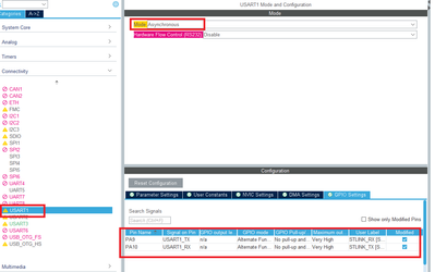

yes iam using USART1 but in UASRT1 is not enabling ,how i enable usart1?
‎2024-11-25 5:46 AM - edited ‎2024-11-25 5:46 AM

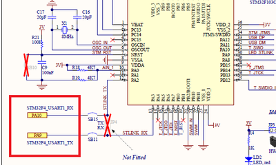

You need just to go to USART1 and select "Asynchronous":
USART1 is on PA9 (Tx) and PA10 (Rx) which is inline with the schematics:

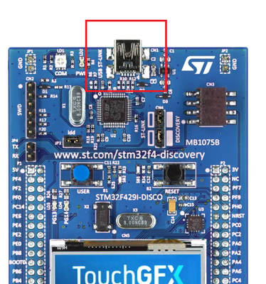

Please take a photo of your board (Top and Bottom) with a good resolution and share it with us.
Forget about CP2102. You can use directly the STLINK module as virtual comport connected to this USB connector:
