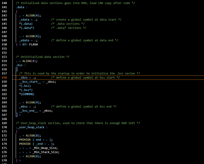

Issue Description:
  • Problem: When compiling a CMake or Makefile project, a build error occurs due to a syntax error related to the linker file.
  • Cause: The .data, .bss, and ._user_heap_stack sections are not attributed to the RAM memory region. Additionally, the RAM attribute is missing from the highest address in the user stack calculation formula.SemerCHERNI_16-1729258098742.pngSemerCHERNI_17-1729258098750.png

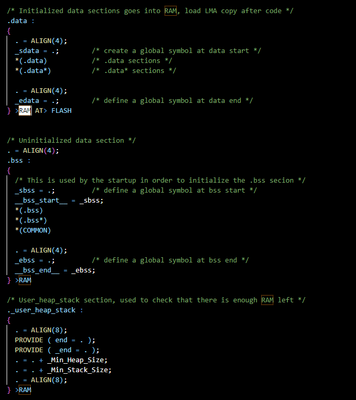

Solution:
  1. Attribute Memory Sections: Ensure that the .data, .bss, and ._user_heap_stack sections are attributed to the appropriate RAM memory region
  2. Update Stack Calculation: Add the RAM attribute to the highest address in the user stack calculation formula.
