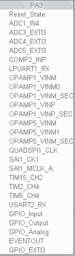

I'm configuring an STM32G474VEH and I right clicked on pin PA3 and I get the attached popup dialog.

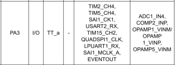

The datasheet has OPAMP1_VINM / OPAMP1_VINP / OPAMP5_VINM.
How do these each of these three items map to the entries in the list below?

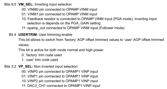

Khouloud ZEMMELI
Hi @Singh.Harjit​ ,
Referring to RM 0440 "Table 200.Operational amplifier possible connection", these extra-signals are needed, each according to the chosen mode.
For OPAMPX_VINM_SEC, we just use it if we activate the Timer Controlled Mux mode.
So there's no CubeMX issue, but waiting for DS update.

I left click on ball PA3 and this menu pops up (see STM32CubeMX).
Since I'm working with opamp1, what do the following mean:
OPAM1_VINM
OPAM1_VINM0
OPAM1_VINM_SEC
OPAM1_VINP
OPAM1_VINP_SEC
STM32CubeMX:
Datasheet - DS12288 Rev 4, page 61:0693W000004J0MVQA0.png
Reference manual - RM0440 Rev 4, page 800:

Khouloud ZEMMELI
Hi @Singh.Harjit​ ,
Best Regards,
Khouloud
Singh.Harjit
Senior II
A suggestion for the CubeMX team - please make all pin configuration available. For example, in the bit definition for VP_SEL, I can select three inputs VINP0, VINP1 and VINP2 in the registers but CubeMX doesn't let me setup pins for these. I can setup the primary pin and then have to make the pin an GPIO_Analog which is confusing because it would be nice to know which pin i've mapped to which opamp/mux input in CubeMX.
