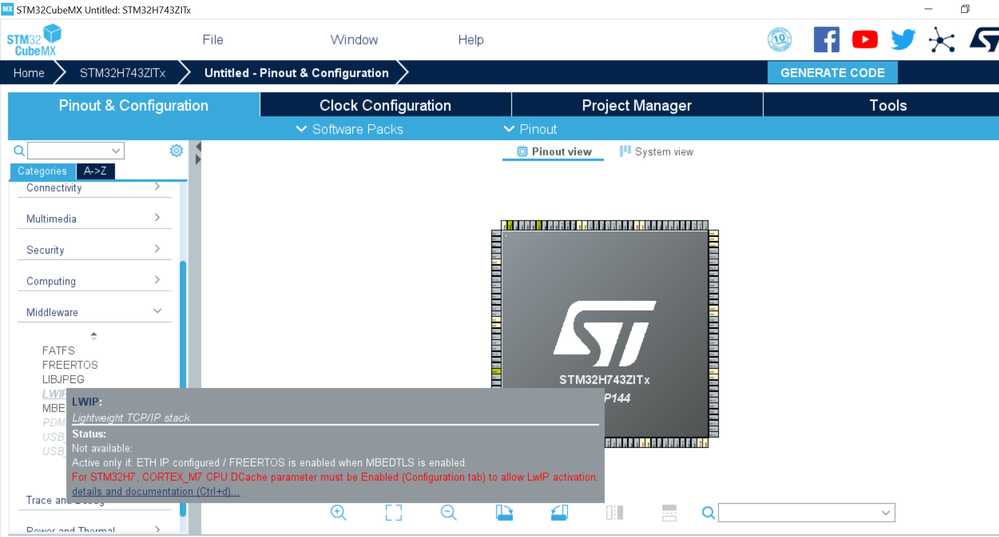

Hi
I'm currently using STM32CubeMX for STM32H743ZITx.
However, I can't enable LWIP function. (Categories -> Middleware -> LWIP)
Previously on STM32F429, I could use LWIP, but I can't even enable the function on this series.
Can anybody help me with this?
Thank you in advance.
Solved! Go to Solution.

Hello @SHong.5​ ,
For H7 series , in addition to ETH , you need to Enable the CPU DCache under system core - Cortex_M7 (for your case) so that LWIP becomes available be enabled.
Best Regards,
Khouloud

Hello Khouloud
Thank you very much. I have solved LWIP issue from above solution.
However, I can't go further with compiling the code.
FILE : ethernetif.c
CODE(line 652) : struct netif *netif = (struct netif *) argument
ERROR : 'netif' redeclared as different kind of symbol
Could you help me with this please?
‎2020-11-05 11:29 PM
Yes @SHong.5​ , it's a known issue , now fixed and the fix will be available for the next CubeMX release (6.1.0) which will be available on site W48.
You're always welcome.
Khouloud

‎2020-11-06 3:11 PM
Either ethernetif.c or ethernetif_h7.ftl from which it is generated.
