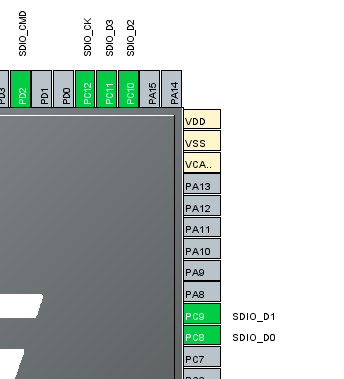

However, using CubeMX 5.x or STM32CubeIDE to create a simple SDIO + FatFS + FreeRTOS doesn't work, will not write to the SD card. Remove FreeRTOS and undo the DMA changes and it will work.

Note: in MX_SDIO_SD_Init hsd.Init.BusWide = SDIO_BUS_WIDE_1B although CubeMX had 4bwide

All that was wrong was the task stack size of 128 words was too small, changed to 256 and now works. Hope somebody finds this useful.
Question to ST, why doesn't 4b wide SDIO work????
You can set it in the Device Configuration Tool, but it still puts SDIO_BUS_WIDE_1B in MX_SDIO_SD_Init().
Adding "hsd.Init.BusWide = SDIO_BUS_WIDE_4B;" like below doesn't work!

Doesn't it initialize the interface in 1-bit, and then switch
bsp_driver.c
/* USER CODE BEGIN BeforeInitSection */
/* can be used to modify / undefine following code or add code */
/* USER CODE END BeforeInitSection */
* @brief Initializes the SD card device.
* @retval SD status
uint8_t BSP_SD_Init(void)
uint8_t sd_state = MSD_OK;
/* Check if the SD card is plugged in the slot */
if (BSP_SD_IsDetected() != SD_PRESENT)
return MSD_ERROR;
/* HAL SD initialization */
sd_state = HAL_SD_Init(&hsd);
/* Configure SD Bus width (4 bits mode selected) */
if (sd_state == MSD_OK)
/* Enable wide operation */
if (HAL_SD_ConfigWideBusOperation(&hsd, SDIO_BUS_WIDE_4B) != HAL_OK)
sd_state = MSD_ERROR;
return sd_state;
Do you have pull-ups on your DATA/CMD pins? If not select pull-up in the pin config. Also consider dropping the speed-slew/rate is you don't have series resistors.
