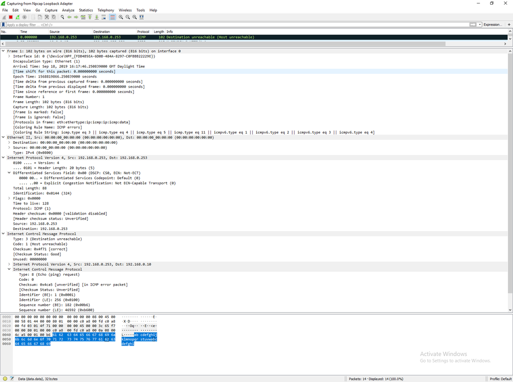

I'm working with the STM32F429ZI (Nucleo) board. STM32CubeMX v5.3.0, generating code for IAR Workbench.
I've set a static IP address, and otherwise kept default settings.
I've created a basic CubeMX project with just LWIP enabled and unable to ping the board.
In the main function call part of code generated calls function MX_LWIP_Init() and in while(1) MX_LWIP_Process() - don't see any error or timeout ,just keeps polling in while loop. ( I could see the ethernet led's ON after passing through initialization phase)
Also when i tried the HTTP server(netconn) example with FreeRTOS was able to get the application working.
Could anyone suggest what I am missing in my test setup ?

A network sniffer is missing. so you cannot see what actually goes on the wire.

I am not experienced in using the network sniffer , when I ping the board (ip address 192.168.0.10) from my pc ( pc id addr 192.168.0.253) - I see host not reachable packet shown in wireshark tool. Does it give any clue ? (Attached the screenshot)
No, unfortunately not much. Just that your board does not answer ARP requests.
If you use LWIP customized by ST, ARP replies should be automatically sent by the ethernet controller.
