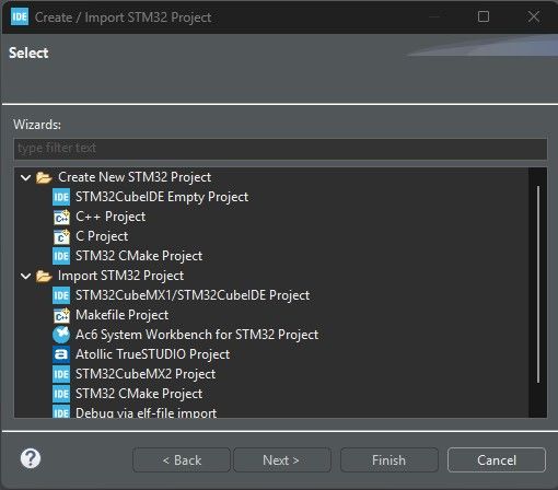

If i create / Import STM32 Project
I only got these options to pick from and i have the feeling something is missing.
So i select:

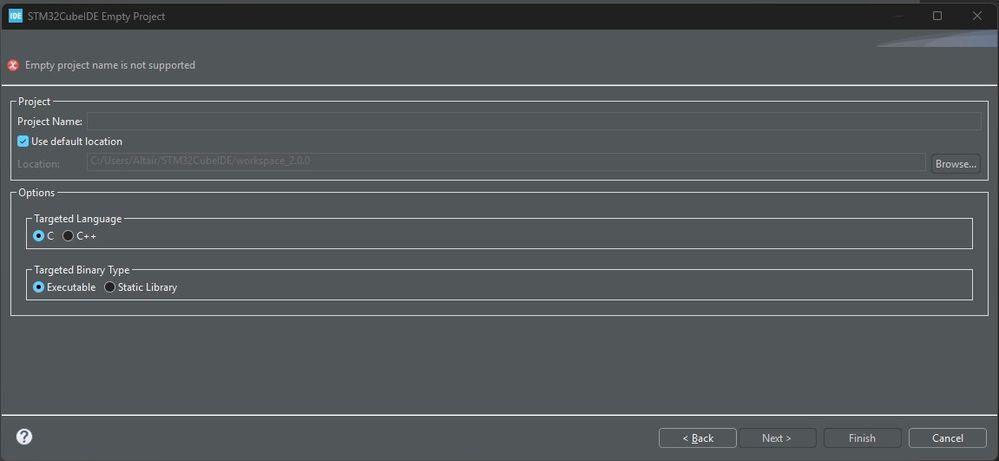

- STM32CubeIDE Empty Project which leads me to this:

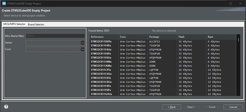

So i select my MCU: STM32G474RETx (for example).
This leads me to this:
All i can really do is creating an empty Project.
This is wrong? I have the feeling it completely ignores which STM Chip i select. I would expect a question if i would want to use CMSIS, LL or HAL drivers.

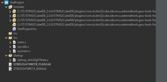

What i am left with is this:
Notice that there is no Drivers folder at all and that i cannot select any of the given Libraries.
To me this doesnt make any reasonable sense. Its almost like an empty C/C++ Project.
