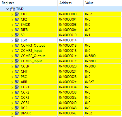

I configured TIM2CH4 on my Nucleo STM32F303RE board to PWM with the LL library, and added some extra code to actually enable the outputs, set compare to with 50:50 duty, enabled the UPDATE IRQ and implemented the ISR to count down from a value initialized to a wanted number of pulses, and if it is 0, I call LL_TIM_DisableIT_UPDATE and LL_TIM_DisableCounter, which in turn I enable in my "start pulses" routine.
Also, I configured the "CH Polarity" in Pinout & Configuration tab to LOW.
So far so good, the scope output, starting with the second run of the routine, looks exactly like I want: The idle signal is low, when I start the pulsing, I see e.g. 10 pulses, and the pin ends on an idle low level.
The problem is that the whole thing starts with the output pin being HI after "booting".
Only after the first pulsing it remains low.
I tried, in main.c in the generated TIM2 init routine, user code section, to add enabling the output already (as opposed to my later init routines), with TIM2->CCER |= TIM_CCER_CC4E.
But that didn't help.
How can I make the system start with a low idling pin before doing the first pulses?
(for now I'll just put in a hack of doing one pulse before configuring the connected device that acts on those pulses, but it's, well, a hack ;) )
Edit: Added requested images

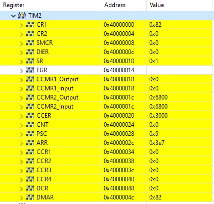

Register contents - if you'd like any of those dissected by bits I can screencap that, too.
(hope this becomes bigger in the real post, in the editor this is shrunk a lot, and I see no way to change that)

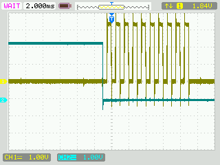

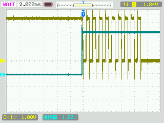

This is that it looks like after booting - note the yellow line starting at a high level.
Then 10 pulses are made, well, 9.5 in this case, as the 1st one is missing the rising edge.
(ignore the cyan signal, it's just a pin toggling back and forth once per run)

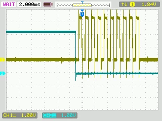

This is what it's supposed to look like: The line starts LOW, and therefore produces 10 instead of 9 rising edges.

Please post the contents of the timer registers, and a timing diagram/scope screenshot of the required and the actual waveform.

Ok, see updated the post.
waclawek.jan
June 10, 2020
How comes your CCR4 is 0, yet the pulses appear to be 1:1 duty? At which point did you take this reading?
Any change if you set CCR4 to non-0?

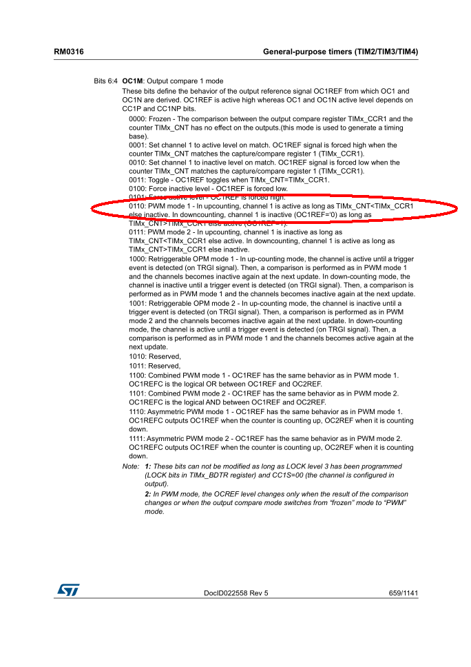

Reference manual, TIMx_CCMR1/2 register description
0110: PWM mode 1 - In upcounting, channel 1 is active as long as TIMx_CNT<TIMx_CCR1 else inactive.
If CCRx == 0, CNT < CCRx is never true because the values are unsigned, so the output is always at the inactive level.
Read 21.3.9 PWM mode for a more detailed description.
This kind of stuff is hard to get right with HAL/LL, because you always have to reverse engineer the library functions to be able to look up in the documentation what they really do. Save yourself the trouble and work directly with the registers.

So, while CNT==0 and CCRx==0, CNT<CCRx is false i.e. output is inactive; and as you've set CCER.CC4P=1, that's 1 on the pin.
> Nuts! I did try to set CCR4 to some value in the user code section *after* the timer init block of the MX generated code, and it had no effect.
As you've also set CCMR2.OC4PE=1 i.e. enabled preload, the CCRx value written after it did not get active as you've did not perform an Update.
