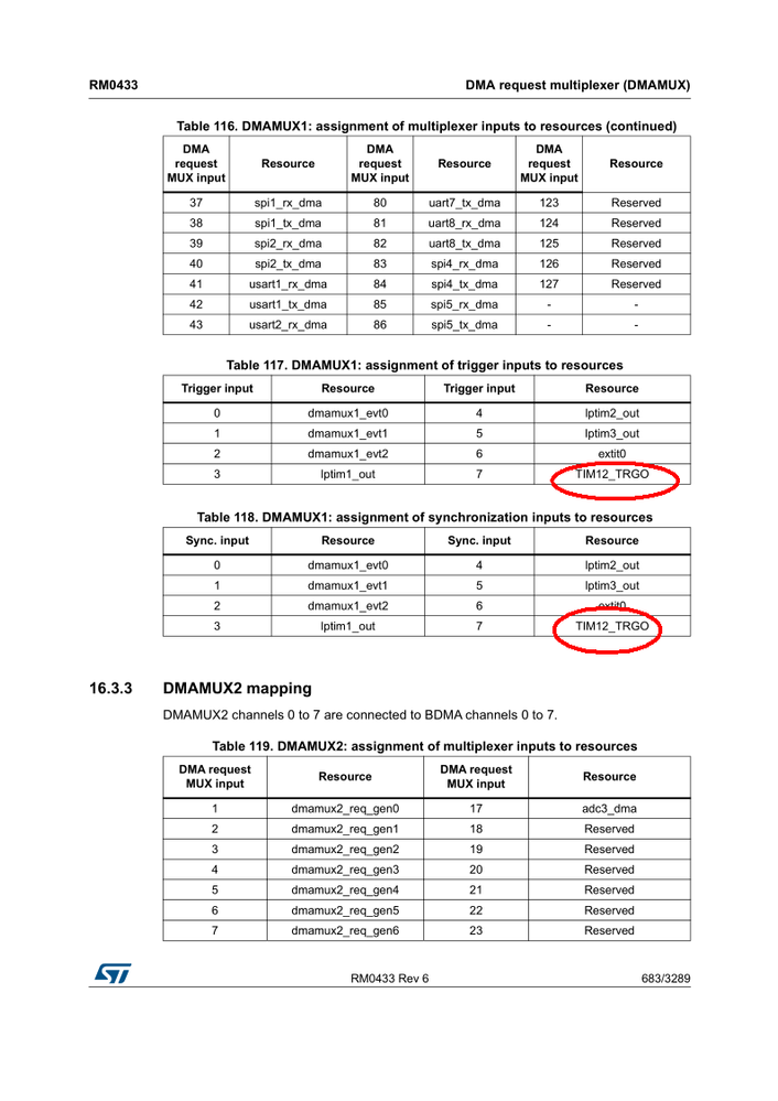

Tim12 TGRO is missing in cubemx.
LLuca.1
In cubemx, the config of Tim12 TGRO is missing.
0693W00000D0YEiQAN.pngWhere in tim1, i can config it under Trigger Out Parameter. This feature is required by DMA request generator.
I tried manually add some code to init this, but none of them work.

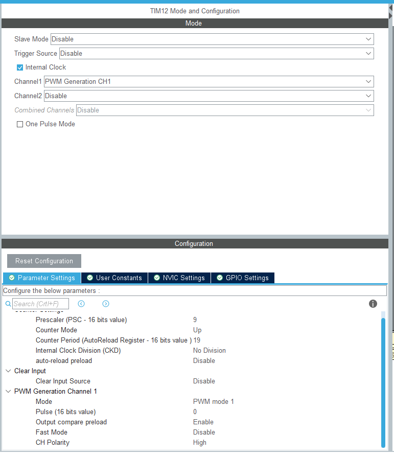

/* USER CODE BEGIN TIM12_Init 1 */
  TIM_MasterConfigTypeDef sMasterConfig = {0};
  sMasterConfig.MasterOutputTrigger = TIM_TRGO_OC1REF;
  sMasterConfig.MasterOutputTrigger2 = TIM_TRGO2_RESET;
  sMasterConfig.MasterSlaveMode = TIM_MASTERSLAVEMODE_DISABLE;
  HAL_TIMEx_MasterConfigSynchronization(&htim12, &sMasterConfig);
  /* USER CODE END TIM12_Init 1 */

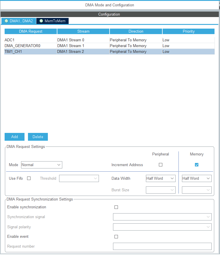

The DMA is used to transfer GPIO to memory
uint32_t test[100] __attribute__((section(".ARM.__at_0x24000000")));
//ignore some code here
HAL_DMA_Start(&hdma_dma_generator0,&GPIOB->IDR,test,100);

waclawek.jan
Which STM32?
> Only master timers have this capability.
No. TRGO from various timers can trigger not only other timers, but in newer STM32 also DMAMUX/DMA, and ADC.

I would wonder if i could use something like this.
0693W00000D0ePrQAJ.pngI configured TM1_CH1 as DMA request. The TM1_CH1 output a 1MHz PWM wave.
HAL_DMA_Start(&hdma_tim1_ch1,&GPIOB->IDR,test,100);
As far as i understand, DMA is like a interupt, so the request is not concerned with the srcAddr. But this failed to run.
Am i wrong? Hoping to hear from you!
