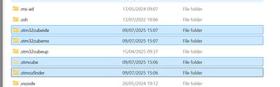

so...just :
Please try to
-Close STM32CubeIDE
-Delete all those files from your PC: .stm32cufinder, .stm32cubemx, .stm32cubeide and .stm32cube
then restart the STM32CubeIDE and retest again.
