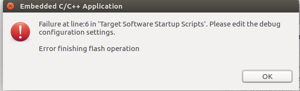

Hello All,
I am using STM32F777IITx MCU based custom board with STM32CubeMx v4.24.
I want to built a application where i want to Read/Write data from/to flash.
I am have written a small application where i write 10 bytes of data to flash and also read those 10 bytes from flash
My code Complies properly with no errors, However, when i tried to run the code in Debug mode i am getting the error mentioned below.
Whereas i have not changed anything in the Startup script, also i have attached the startup script below

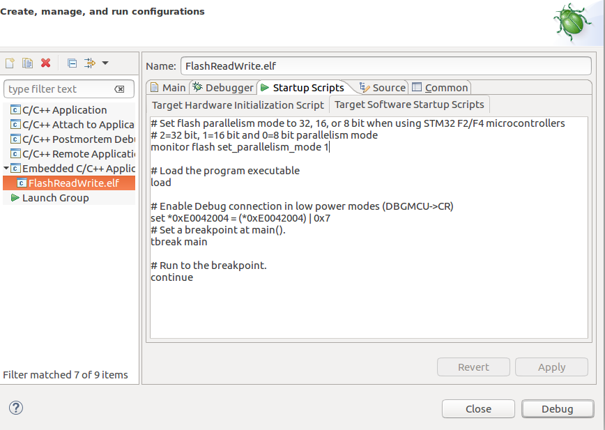

Pavel A.
October 10, 2019
Have you tried to change set_parallelism_mode to 1?
--pa
Utkarash Patil
October 11, 2019
Hello Pavel,
Thank you for the response,
I Changed the parallelism mode to 1 and tried to debug however still facing the same issue with same error pop-up as mentioned in last post.
I have attached the screen shot of startup Script please check.
Please help with this earliest.
Thanks and Regards
Utkarsh

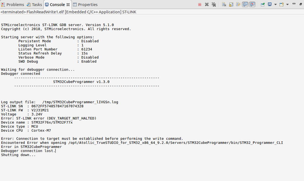

Pavel A.
October 12, 2019
It looks like some error occurs in the "load" command.
Please open the Debugger console window and see what it says there.
(the output should begin with "STMicroelectronics ST-LINK GDB server" .... )
-- pa
Utkarash Patil
October 12, 2019
Hello Pavel,
Thank you for the Response,
I have attached the error message on the console, however i am not getting anything like "the output should begin with "STMicroelectronics ST-LINK GDB server....." .
ERROR MESSAGE:
Error: Connection to target must be established before performing the write command.
Encountered Error when opening /opt/Atollic_TrueSTUDIO_for_STM32_x86_64_9.2.0/Servers/STM32CubeProgrammer/bin/STM32_Programmer_CLI
Error in STM32CubeProgrammer
Debugger connection lost.
Shutting down...
Please check the error and help at the earliest its urgent
