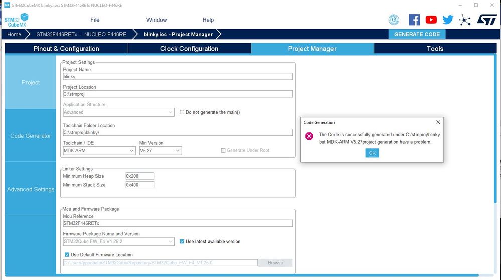

Hi
I am facing issue with the "generate code" to generate the boiler plate code for the nucleo-f44re
0693W000005Bu6gQAC.jpghere is the software that I am running with :
STMCubeMX_v6-0-1
Keil ARM-MDK 5.32
java version "1.8.0_271" (Java 8 I believe) , which is the recommended version of Java to run the CubeMX
*I even install the STM32CubeMX in the most shallow C directory "C:\<here>", so that I would not encounter any issues with too long path names*

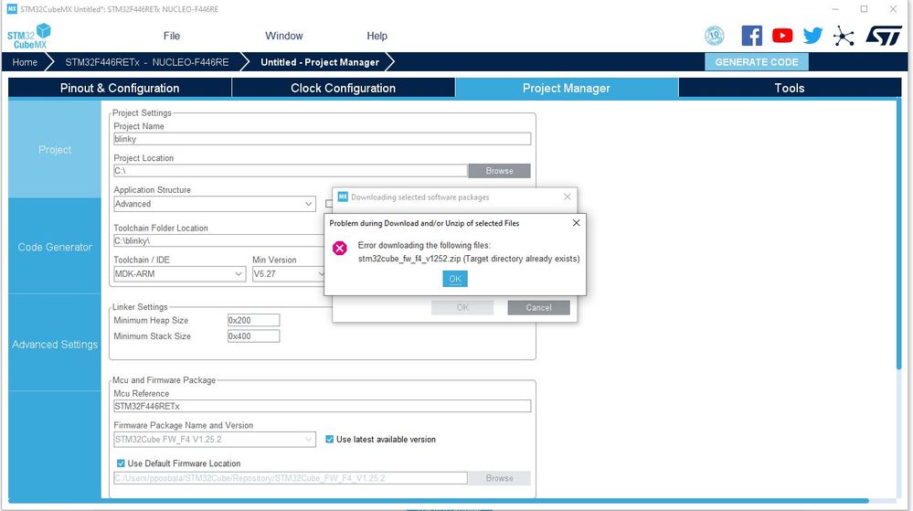

This "generate code" issue comes right after I resolved another Issue with "installing stm32cube_fw_f4_v1252 libraries"
0693W000005Bu7jQAC.jpgI managed to resolved this "stm32cube_fw_f4_v1252" library installing issue by manually going to the C:\\<User>\STM32Cube\Repository and manually unzipping the files .
could the problem of "generating the code", stem from this method of resolving "the stm32cube_fw_f4_v1252 library installing issue"?

Good, I found your issue !
STM32CubeMX is pointing to JAVA 13
2020-11-19 13:52:38,448 [INFO] MicroXplorer:564 - Detected Java Version = 13.0.2
As described in the STM32CubeMX User Manuel UM1718.pdf, CubeMX is not validated with JAVA 13.
Can you clean your environment by installing only JAVA8 and updating your Java path is configured?
Best regards,
Nesrine

For the second point, as the message is reporting, it indicate a directory with the CubeFW name exists in the repository.
So, to fix the issue (workaround) the user should inspect the Repository folder, and delete the unexpected directory.
Best regards,
Nesrine

yup i have already resolve the second pictures issue, I extracted the zip file and place it in the Repository folder, and no longer see that error message.
The issue now seems to be the "project generation problem"
I need the STM32CubeMX log file.
Can you please send us the STM32CubeMX.log under "C:\Users\<username>\.stm32cubemx".
Best regards,
Nesrine
hi here is the log file :
Best regards,
Nesrine
oh wow thanks ! Can i ask how can I clean my environment by removing this java 13, and updating my java path to only java 8 ? because in my cmd prompt it seems like there is only java 8 installed
You should remove the JDK v13.0.1, restart, delete all non necessary files in that directory .
