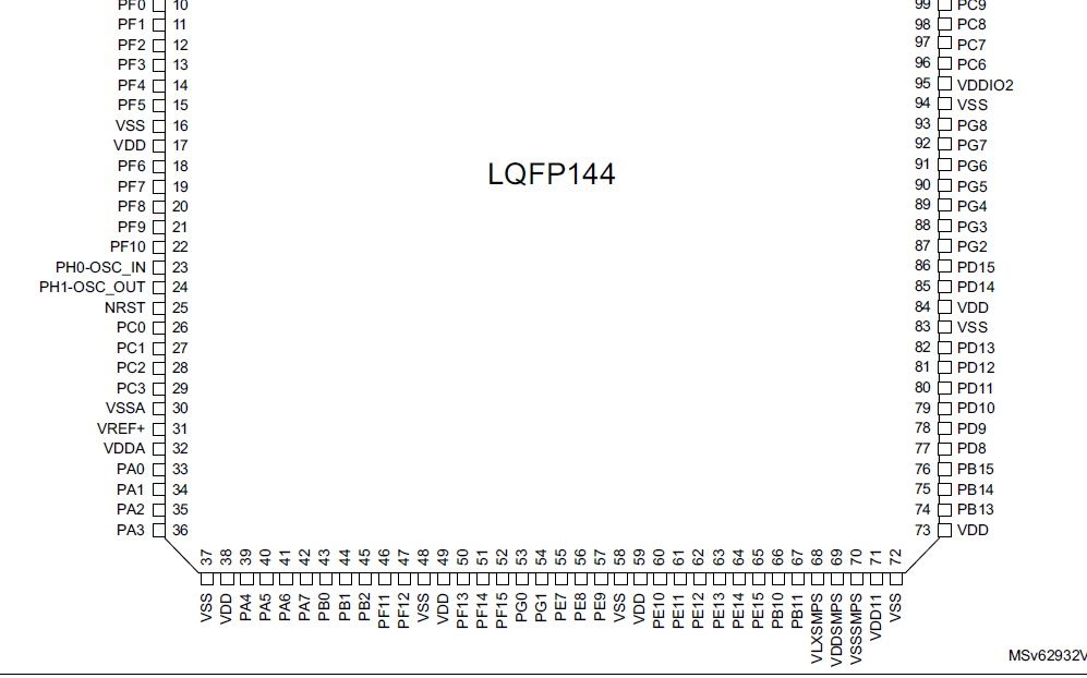

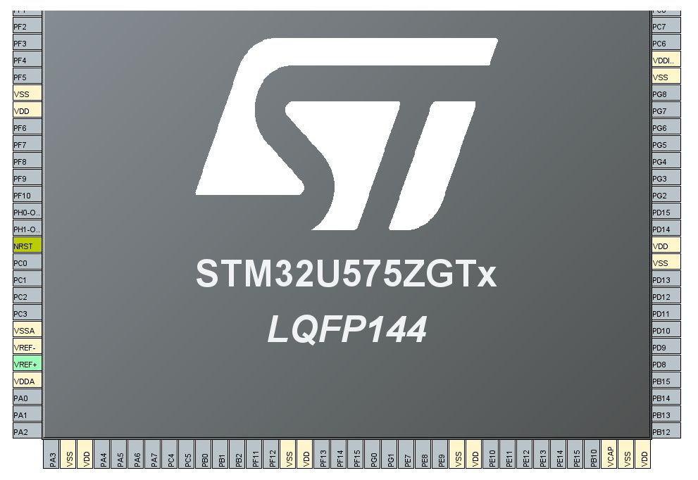

I like to use the LQFP144 case of the STM32U575, but unfortunatly the case showed is wrong, see attaced pictures

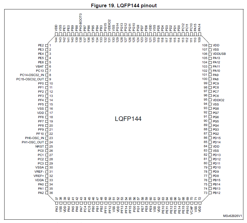

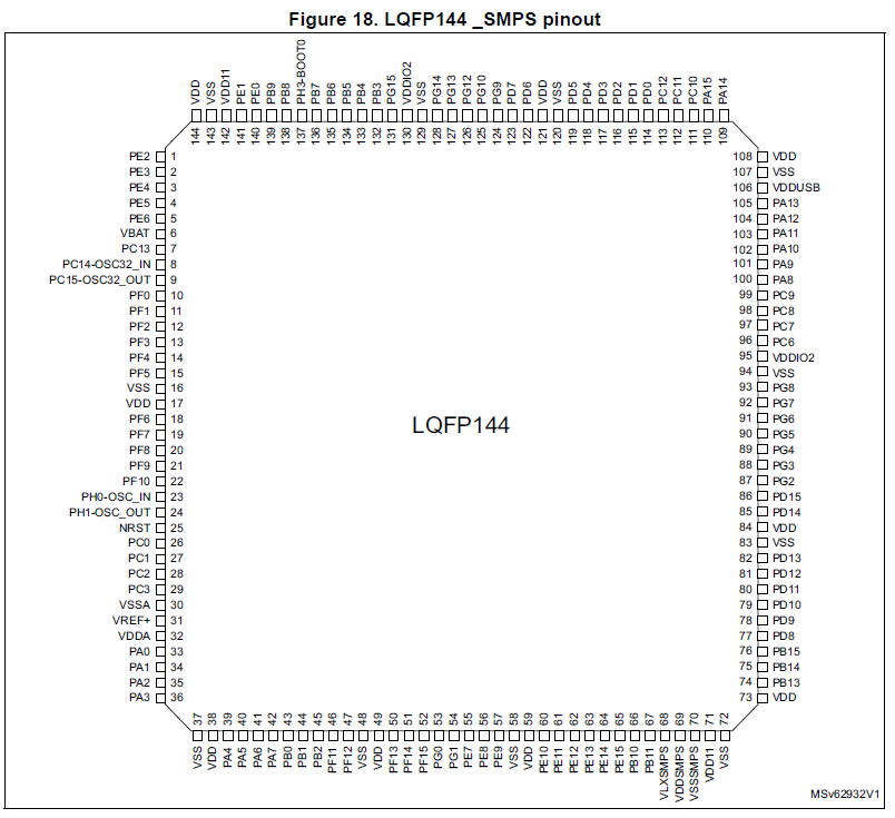

In fact there is no mistake, STM32U575ZGTx is available on LQFP144 package (with SMPS and without SMPS) and with a different pinout.
LQFP144 pinout with SMPS available :
LQFP144 pinout without SMPS, corresponding to your STM32CubeIDE's picture:
Please refer to the section "4: Pinout, pin description and alternate functions" of the attached datasheet.
