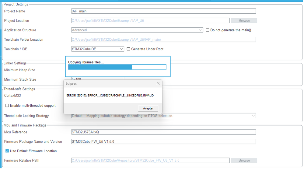

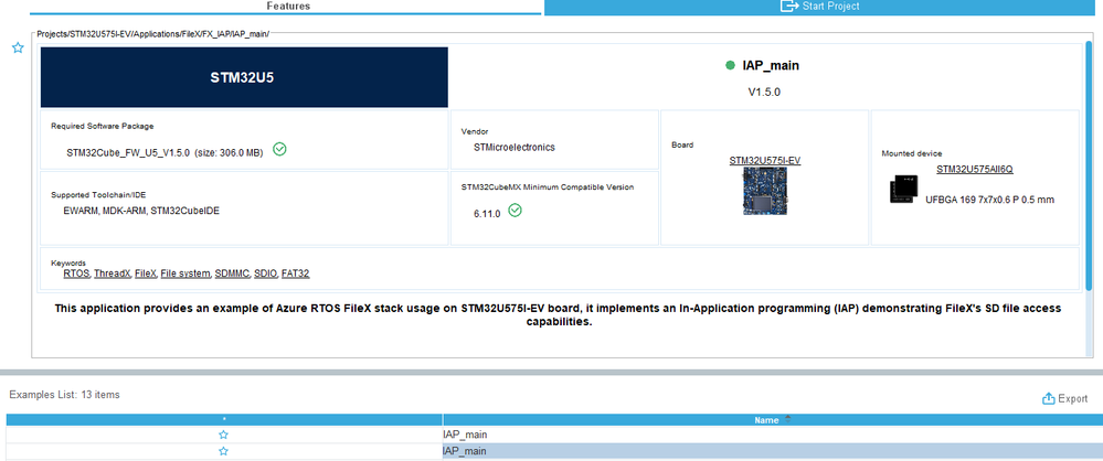

I want to test the "IAP_main" example for the STM32U575I-EV.
I start the project as follows :
Then when I try to Generate Code for the STM32CubeIDE in CubeMX the following error occurs:

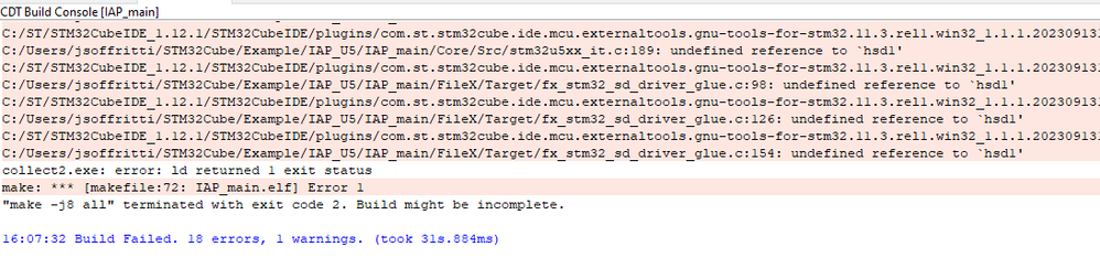

 The code gets generated and I can open it in STM32CubeIDE  but it doesn't build properly:
 The build errors says that the MX functions called in the main file are not linked and there is no reference to them.
I have attached the build log where the errors are displayed.

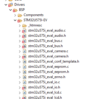

If I select Generate Under Root the first error disappears but new build errors are generated:
 All these files do not build.
So look at the errors , it telling why...especially the first error (often same reason (include missing etc.)).
Or show it. :)
