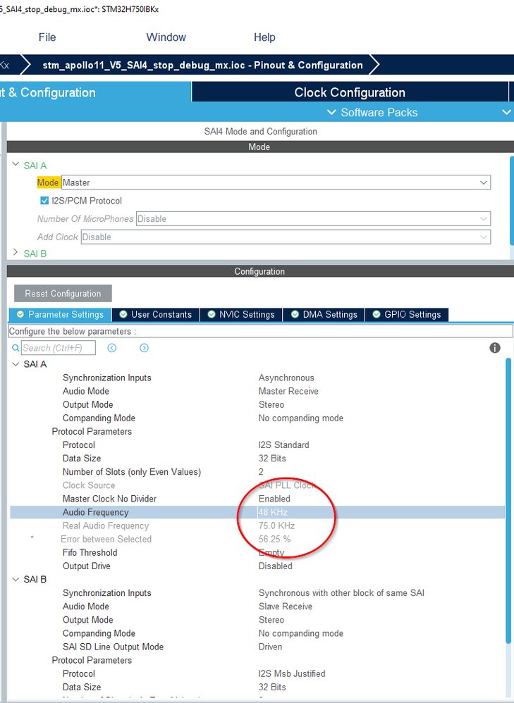

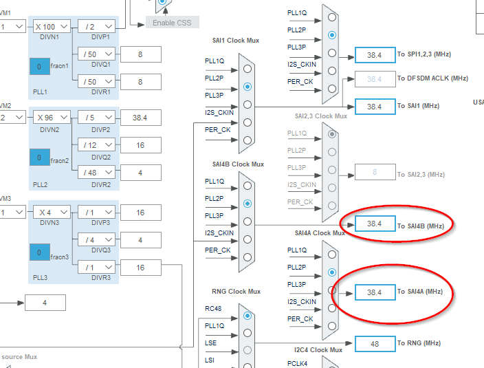

I have created a clock of 38.4MHz for SAI4A and SAI4B but I am not able to get 24.0kHz sample rate for a I2S 32bit Master input.
All sample rages seams to relate 4.8MHz clock.

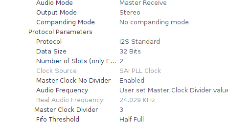

you really want 24kHz sample rate ? this is no standard frequ. , but ok, lets try:
0693W00000SuOnBQAV.pngwith pll setting
comes close to your 24khz ;
if you want frequ. exact 100% , you must use a matching clock, ie, 49,152 MHz.
