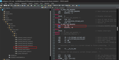

@Mahmoud Ben Romdhane I have found a minor typo in this file generated by the CubeMX for EWARM:
\Middlewares\ST\threadx\ports\cortex_m33\iar\src\tx_thread_schedule.s
The typo is on line 149:
    MOV     r0, 0                  // Disable BASEPRI masking (enable interrupts)
The correct syntax is of course
    MOV     r0, #0               // Disable BASEPRI masking (enable interrupts)
If I correct the typo, every time I re-generate code from the CubeMX, the tx_thread_schedule.s file get overwritten and the change would be lost but not for source code control diffs. Perhaps you can just add this to the internal ticket that you have already created?

ScottyWinsome
@Mahmoud Ben Romdhane  for the second issue, the problem is that the STM32CubeMX v6.16.0 outputs the erroneous .s file every time I need to regenerate code - why don't you just try it for yourself, it is as easy to duplicate the observation as a button press, namely, generate code, and you will see the output tx_thread_schedule.s has the line with the typo - have you even tried this simple step to duplicate the observation?

Hello @ScottyWinsome ,
For the second issue:
The erroneous code is protected by compilation flag that is not defined by default.
>#if (defined(TX_ENABLE_EXECUTION_CHANGE_NOTIFY) || defined(TX_EXECUTION_PROFILE_ENABLE))
It is a normal behavior that the code after generation remains by default because it is not placed between
User Code begin and User Code end.
You need to change the code line in the file tx_thread_schedule.S under
Repository\STM32Cube_FW_U5_V1.8.0\Middlewares\ST\threadx\ports\cortex_m33\gnu\src\tx_thread_schedule.S
and regenerate the code.
Thanks.
Mahmoud
@Mahmoud Ben Romdhane thank you, that is a handy work-around for the second issue.
