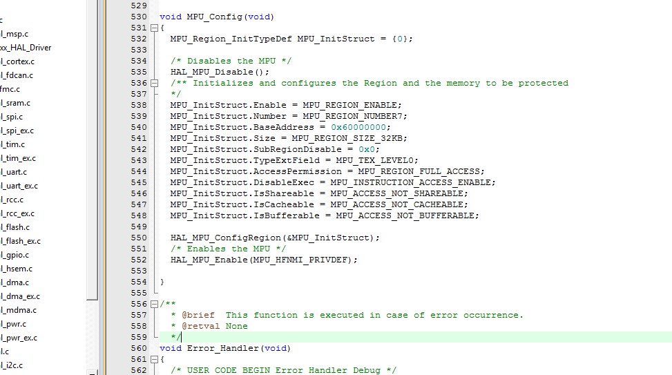

From RM0433, FMC chapter, Supported memories and transactions
General transaction rules:
The memory region MPU attribute must be configured as “Device�? or “strongly-ordered�?
in order to prevent issues on devices that do not have the byte select feature. As an
example, if byte accesses are performed to 16-bit memories with the MPU attribute set
to “Normal memory�?, the AXI transaction size is 64 bits and the FMC splits the
transaction into four consecutive accesses while only one access is expected instead
of four.

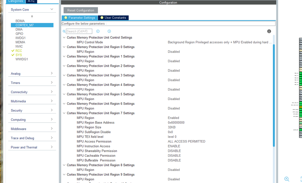

Hi Amilton ... Yes had local FAE give some help.
The Memory has to be put into a Region this can be done from CubeMX, I made sure CubeMX was updated.
Only had this working yesterday so have not fully checked out
KR John W
