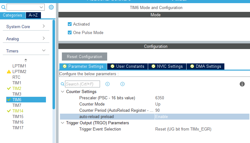

1) I have set below in STMCube.

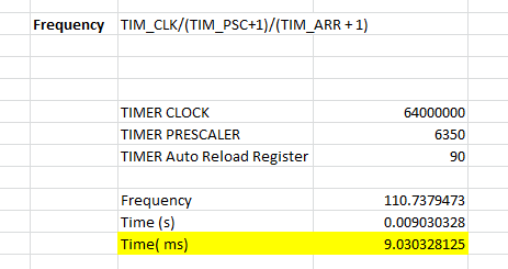

0693W00000QNyvvQAD.png2) As as Per calculation.0693W00000QNyxhQAD.png3) When I write ARR = 10 and after ARR = 90. .
a) The Timer first generate delay according 90.
b) Then according to ARR = 10.

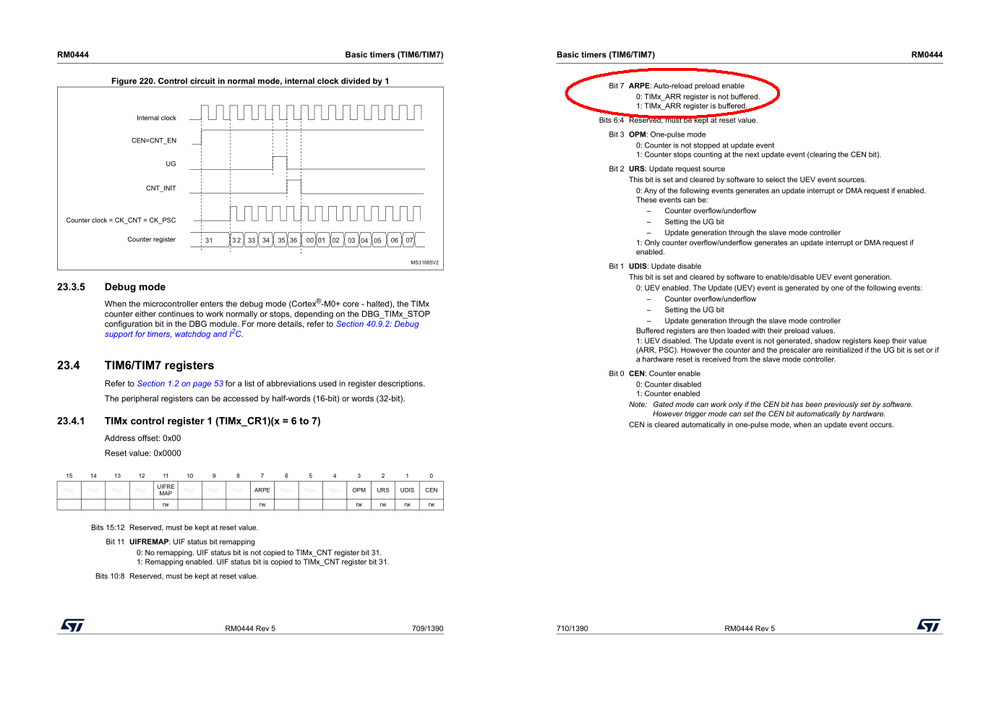

I don't use Cube. Who knows what those functions do now, and what will they do in the next version of Cube.
Timers are simple, read the TIM chapter in manual and use registers.
Preload of TIMx_ARR is controlled by TIMx_CR1.ARPE, but note, that TIMx_PSC is unconditionally preloaded, if you want to get it active immediately you have to force an Update event, usually by setting TIMx_EGR.UG.
Most of the time you want the preload to be active.
