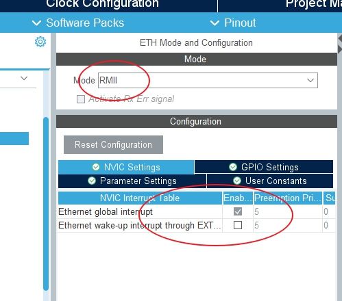

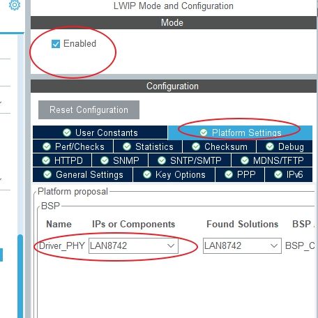

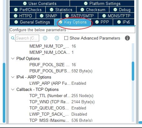

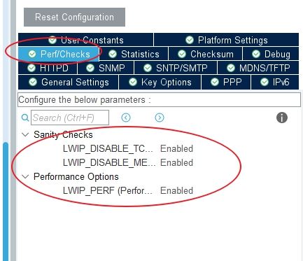

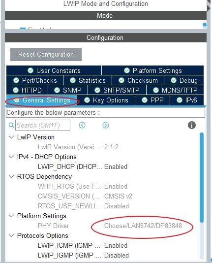

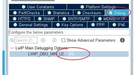

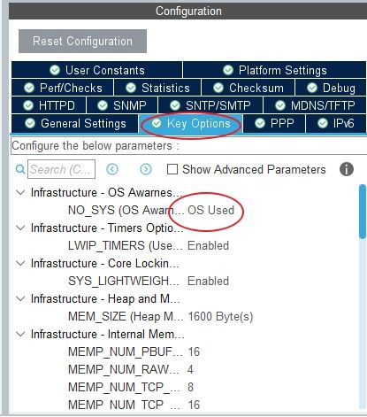

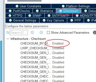

I use STM32F7508-DK generate freertos LWIP project, I can build the project,and download the target,the project can get an ip from router,but I could not ping it,by debug, the HAL_ETH_IRQHandler(){
the error code is HAL_ETH_ERROR_DMA, hal version is
1.17.0

HShiy.1
HShiy.1Author
February 28, 2023
my STM32CubeMX version is 6.7.0
