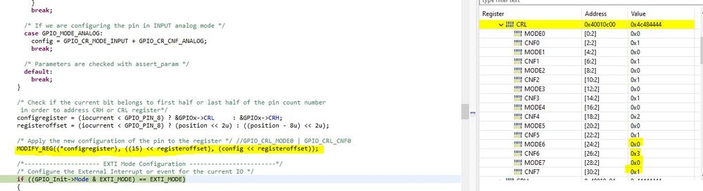

Debugging it seem that HAL_GPIO_Init(GPIOB, &GPIO_InitStruct) in HAL_I2C_MspInit() put Bus busy high.

Stequila93
August 23, 2021
Hello Thanks,
I tried to enable in the CR1 register but i keep getting error before initializing.
About AFIO i don't see anything of strange i would check it better tomorrow.
I checked in the register if was mapped at 0 for pin 6 7 and its fine, i have nothing over i2c1 its an empty project with just swd debug.
Errata was saying what i did (maybe i did it wrong).
Is fine that in GPIO_INIT set pin 6 and 7 as INPUT?
0693W00000Dq9JXQAZ.jpgI'm getting MODE 00 and CNF 11 on the table configuration is "reserved".
It doesnt match with what i set up on stmcube that was output open drain with no pullup.
I'll check more tomorrow.
Thanks a lot.
Stequila93
Stequila93AuthorBest answer
August 24, 2021
Well thanks,
I found out that it was not setting up the speed of the gpio in the structure sent to the gpio init, so it was set up as input and not as output OD.
 0693W00000DqCKsQAN.jpgBy the way it's generated by stmcube so is it missing while generating or i missed something in cube?
Thanks again
